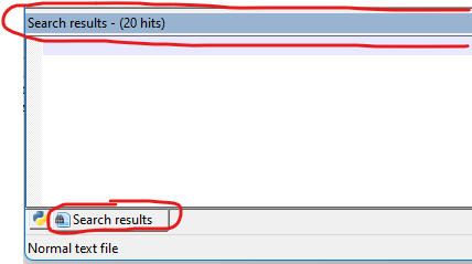

                I’ve never undocked the panel; I don’t even know how to do that.
                If you double-click either of these areas:
                then the entire pane/panel will become a free-floating window, detached from the main N++ window.
                Note, however, that in my example I have TWO tabs in that panel, so what you double-click on makes a difference:
                • title bar : opens a new window with all tabs from the original panel
                • tab : opens a new window with only the tab double-clicked
                So after you have the free-floating window open, double clicking the title bar on that will return it to its original location, docked in the main N++ window.
