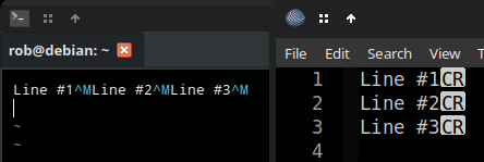

              Just to clarify, what @ThosRTanner means by “teletype mode” is the way a terminal editor like Vim displays unaccompanied carriage returns, i.e., by joining the “lines”:
              Like any editor, it hides properly formed Windows EOLs unless you enter :set list (“show whitespace”), followed by :e ++ff=unix (“reload file in Unix EOL mode”):
              Scinterm is the only terminal editor I know of using Scintilla. To try it, you’ll have to download a source tarball, extract it beside the Scintilla source tree (checked out to a compatible version first), then run the makefile.
