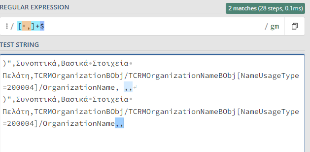

          it doesn’t match them all:
          EkopalypseE Terry RT 2 Replies Last reply Reply Quote 0

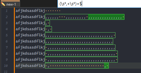

            maybe something like this??
            It uses \s, so if you want to use only spaces, you need to replace this with the correct symbol.

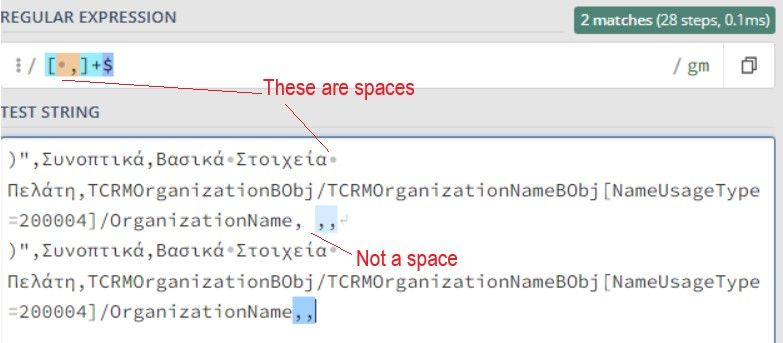

                        In the following posts to the OP stating my solution didn’t work noone seemed to realise (or at least state as such) that it does meet the request. The OP’s image clearly shows that the first match (in light blue) has another character preceding the 2 commas which is NOT a space. A space character can clearly be seen just above at the end of the first line. It is denoted (in regex101.com) as a thick dot hanging mid level on the line. See my amended image showing the differences.
                        So it must be another “white space” character(s), possibly replace the space in my solution with [[:space:]] as this includes a non-breaking space, amongst others. The only way to determine that would be to investigate it in Notepad++ and find it’s hex value.

                          your solution doesn’t match this case:
                          Yes, it does, for me. But maybe you have some other context
                          You have NBSP characters in there.
                          That’s why my solution didn’t work for you.
                          So I take back my criticism of Mark’s suggested solution, as \h will actually match NBSP.
                          Let’s chalk it up to an OP wanting a solution to a problem/data he really doesn’t understand. :-P
