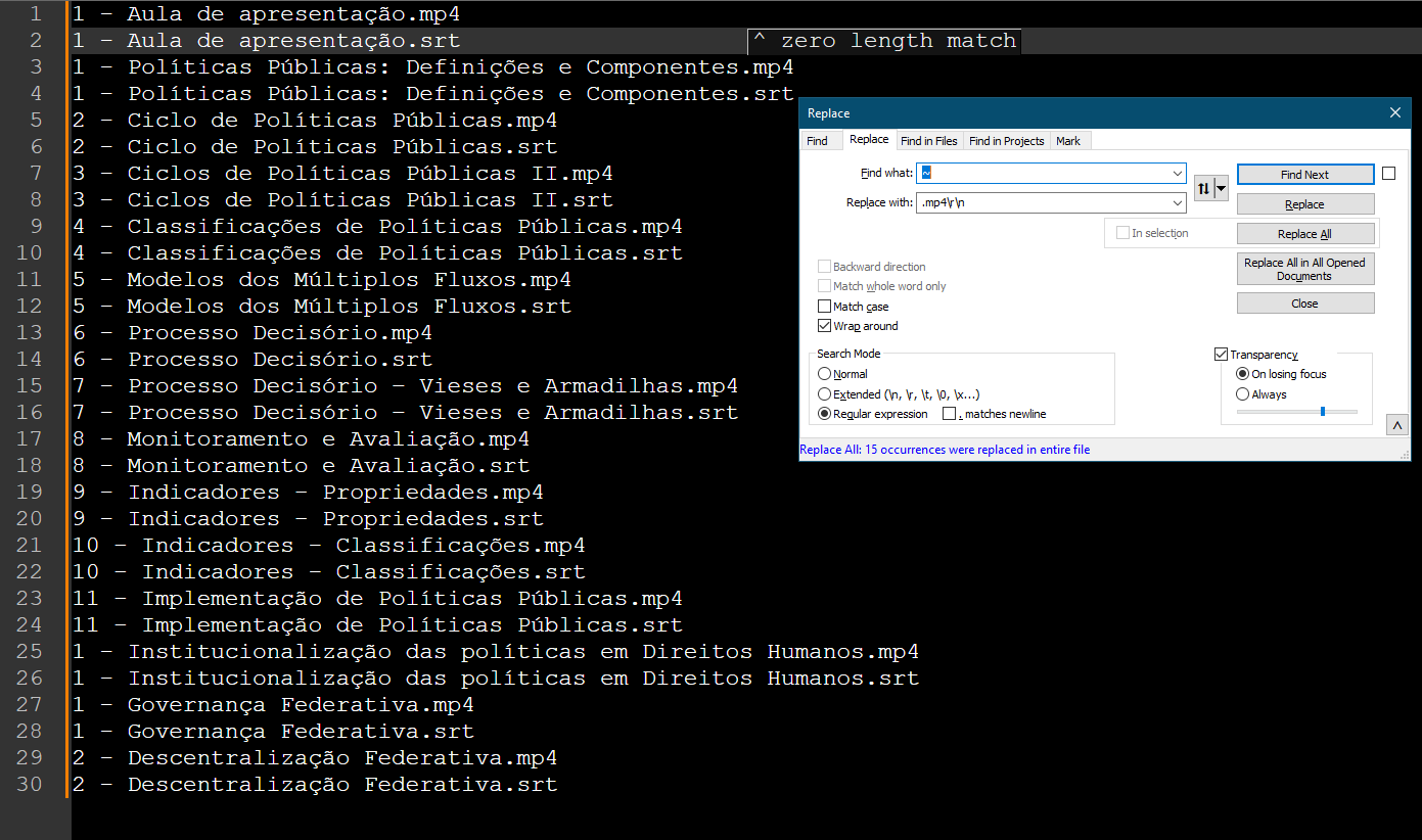

    I want every 2 lines to have specific text added at the end of each of them.
    6 Posts 3 Posters 2.7k Views 3 Watching
    • GabrielPG Offline
      GabrielP
      for example lets say i have the following text
      line1
      line2
      line3
      line4
      line5
      line6
      I want this text to become
      line1.mp4
      line2.srt
      line3.mp4
      line4.srt
      line5.mp4
      line6.srt
      ive searched for a bit and couldnt fine a solution to do this specifically, thanks

          • GabrielPG Offline
            GabrielP @PeterJones
            @PeterJones is there no way to add text to odd lines and then another text to even lines?
            right now im trying this,
            (?-s)^(.+\R)(.+\R?)
            \1.mp4 & \2.srt
            which i saw here
            but unfortunately my text goes from this
            (im replacing ONLY the first 2 lines btw, to show you that it ends up affecting the 3rd line too)
            1 - Aula de apresentação
            1 - Políticas Públicas: Definições e Componentes
            to this
            .mp4 & 1 - Aula de apresentação
            .srt1 - Políticas Públicas: Definições e Componentes
            when if im only replacing the first 2 lines, it just want it to become this
            1 - Aula de apresentação.mp4
            1 - Aula de apresentação.srt
            • GabrielPG Offline
              GabrielP @mkupper
              @mkupper this worked great, thanks!
