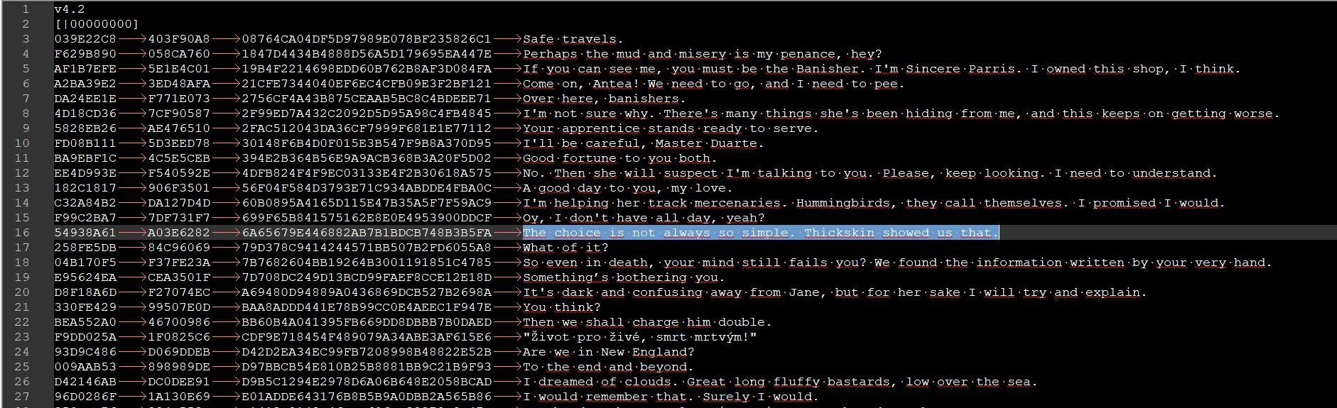

                Now I could easily give you another regex to fit your new requirement however I think it might be doable for yourself to give it a go. From your image you want to start immediately after a > and go until the next tab is found. With that knowledge you should be able to edit the regex. Use the www.regex101.com website to read and decipher what the code means. Try it, then show us what you have if unable to achieve it and we can help. We do like people to try this themselves as we aren’t a data transformation service, but do expect some learning to take place by yourself as the posts continue. There are also several FAQ posts which have references to valuable regular expression sources if you need a bit more knowledge. I also use www.rexegg.com as a quick reference tool.

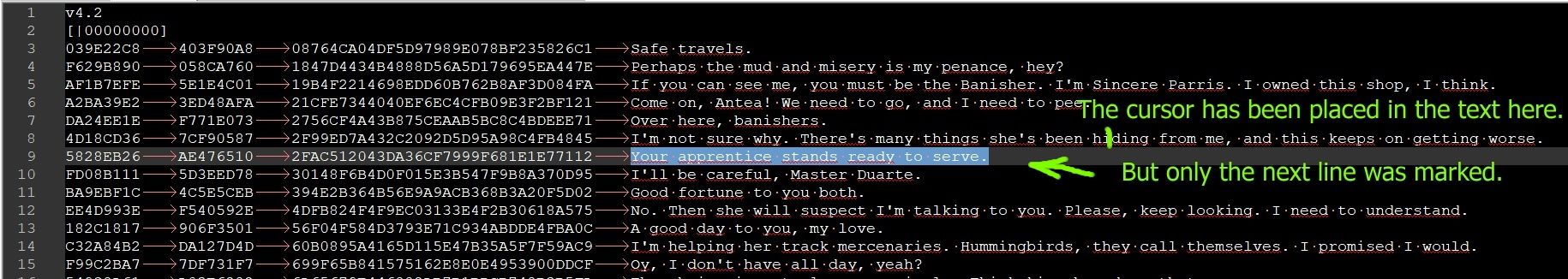

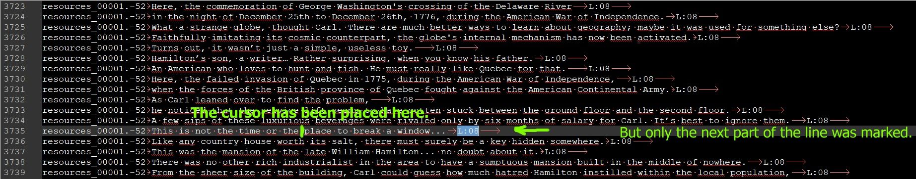

                  But I have a problem with the fact that it only selects part of the next line, not the one where I place the cursor.
                  This regex expression in this text: (?<=\t)([^\t\r\n]+)$
                  This regex expression in this text: (?<=\t)([^\t\r\n]+)(?=\t)
                  Is this a necessary feature or can it be modified in some other way?
                  I would need the beginning of the selection to look before the cursor and the end after it.

                    You obviously don’t understand how a regular expression works. Any look behind has to be a fixed number if characters, so placing the cursor in the middle of what you want to select will never work.
                    As I said in my first reply The macro I created below will, from the current position of the cursor, select the next valid string. You readily accepted the first solution suggesting you had tested it and it worked for you. So why with the second request have you changed your process and put the cursor in what seems to be a different location on the line?
                    But if you absolutely need to place the cursor there then the simple addition of another key sequence to the macro might fix the problem. I’m not on a PC right now but there is a shortcut key combo, I think it’s alt+home which moves the cursor to the start of the line the cursor is currently on.
                    So as a test, place the cursor somewhere on a line and use that key combo and see if it moves it back. There is the shortcut mapper in the menus that will show current key combos that achieve different things. It might be something you will find useful.
                    So once the correct shortcut is found you will need to re-record the macro with the move to start of line key combo first, then the find function with the regex, then a ctrl-c to copy the text. I will leave that as an exercise for you. The online manual has information of the macro system if you’re unsure. It is linked from the ? menu.

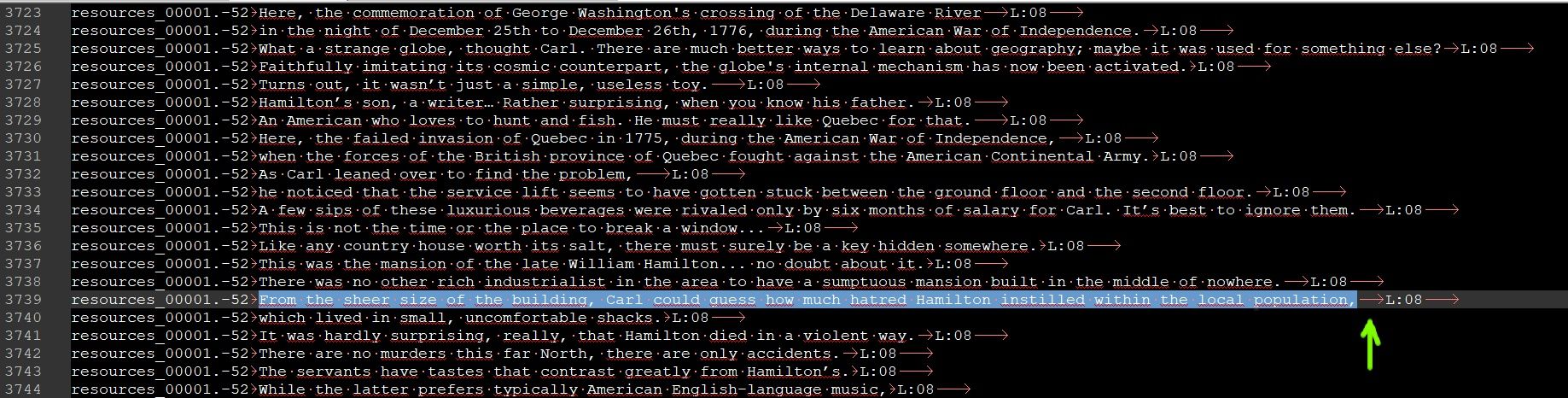

                      I’m sorry, I probably didn’t express myself very accurately the first time, it could also be the language barrier. However, your help brought me to my goal and now I have two macros that fulfill exactly what I needed and it’s to your credit. Thank you again for your time. :-)
