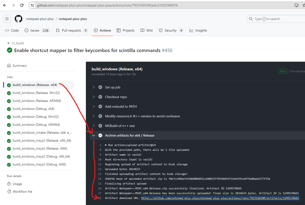

                          You can try it out now by going HERE.
                          Choose the “build” for the Notepad++ you use under “Jobs” on the left and then follow the red arrows in the following to download a zip file containing a trial notepad++.exe:
                          Rename your original notepad++.exe and then copy the downloaded one to the N++ folder.
                          Start N++ as usual and try out the change.
                          deleeleeD 1 Reply Last reply Reply Quote 2
