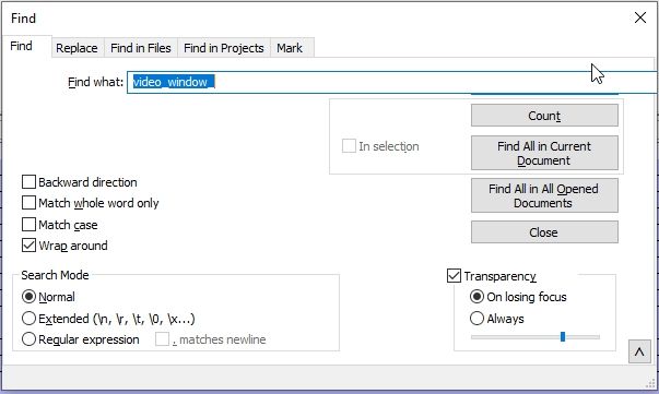

      Has anyone seen this issue where the “Find what:” text box stretches all the way across the Find window? It’s been happening to me for many versions (now on 8.6.2), but it doesn’t display like this right away, only after time with the current session. If I close NP++ completely and restart the app, it’s fine again at first (but not for good). I’m often going back and forth between normal/extended/regex searches, not sure if that’s relevant. Thank you!

        I’ve never observed that. What happens if you resize the window horizontally, anything?
        big_guitarB 1 Reply Last reply Reply Quote 1

          @big_guitar,
          I recall seeing the same thing that you are experiencing. It was a long time ago and was one of those glitches that as it was not too disruptive I ignored at the time. I checked my own notes and can’t find any notes to myself about it either.
          Can you post your ? / Debug info data?
          I noticed your find box has square corners and background filled buttons leading me to wonder what operating system you are using.
          Down in the lower right corner of the find box is a button with ^ in it. Click than and click the resulting V. Does this fix the width of the find field?

            yeah, I tried resizing the Find window many times past & present, no difference, but if I kill the program and restart it, it’s ok for a bit.

              I’m just running Windows 10 Pro currently… Yes I think I’ve encountered this issue going back some time.
              No, toggling that shrink/restore button in the lower right has no impact, tried that many times historically.
              There doesn’t seem to be a command line to run in debug mode according to --help, not sure what your asking about regarding ‘debug info’…
              I do perform a lot of “Find all in current document”, but other than that,
              I’m not convinced that it’s about the content of what I’m searching for…
              but I see that config file is under the AppData\Roaming
              I usually leave the Find window in a transparency mode, and it will be fine, I’ll use other apps, and just one of the times I navigate back to NP++ and reactivate ‘Find’ (or CTRL-F), it displays with the issue all of a sudden prior to my next search…

                I meant the ? at the right side of the main menu. Most Windows applications have the Help menu there. Notepad++ has always used ? instead of the word Help. Usually we’d say “Help / About” and in Notepad++ it’s “? / About”. Anyway, just above “? / About” is “? / Debug Info…” As you said you are using win 10 Pro I don’t think knowing the debug info would be helpful.
                I found this comment by you to be interesting:
                From what I recall, I was seeing a similar thing. I’d switch away from Notepad++, do things for a while, switch back, and when I did Ctrl+F I’d get the wide find box field.
                I tried recreating the issue without success though did discover that when on the Find field that Alt+Up or Down arrow is the same as clicking the V dropdown thing at the right side of the Find field. That may be useful to you if the situation happens again as then you can at least bring up the dropdown list though you can’t see the V thing.
