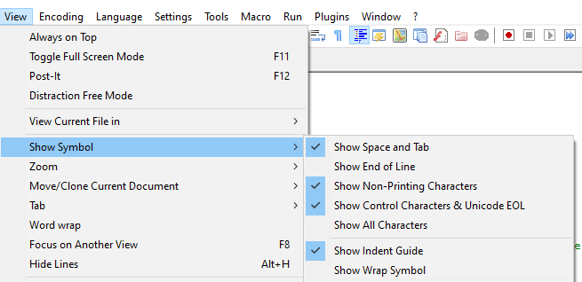

        • View > Show Symbols > Show Space and Tab – this will use special glyphs for the space and tab symbols, to make indentation obvious

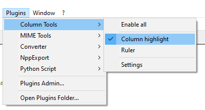

        • Install the ColumnTools plugin and enable Plugins > ColumnTools > Column Highlight
          This puts the “edge column marker” at the current column (the cyan vertical line in the screenshot below)

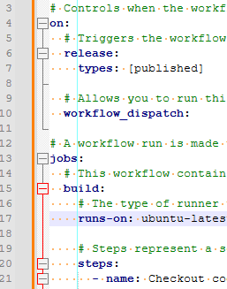

        The results of these two together:

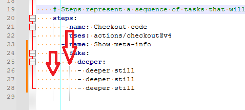

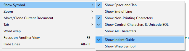

        update: three things, actually. View > Show Symbol > Show Indent Guide
        This puts a separate vertical line at every tabstop level; Settings > Preferences > Language > yaml > Tab Size: ____ determines how far apart the Indent Guide lines are.
