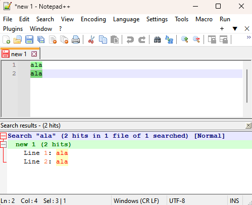

      When I run Find All in Current Document my results looks like that when I start program, so it is ok:

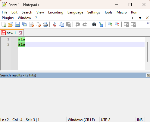

      When I search with Find All in Current Document for any string one more time, my search windows is greyed out and I have to press each time F7 to show results and get previous window:
      This is so annoying have to press this F7 all the time. Like some very basic functionality is not working. Why it is not updating automatically. It was working normally for long time and after some update it was broken and no chance to bring it back.
