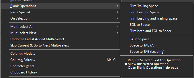

                  @mkupper Speaking of having settings in a new popup and in Settings -> Preferences, rather than have a new popup be the new precedent to add precaution for Blank Operations, I suspect it would be easier to have a new menu item type be the new precedent. All items in the Edit menu are currently verbs or actions that copy text, paste text, select text, find text or change text. New menu items in-line with the current Blank Operations menu items would be easier to find and much more visible. However, the new menu items I have in mind would set a precedent in that they would toggle a setting that does not fit in neatly in Settings -> Preferences. Currently, the Encoding menu and the Language menu have a radio button to show which item is currently selected, so showing a menu item in in a menu is not new for N++, but saved setting shown and changed in a menu would be a new precedent. I have attached an image showing a mock up of the menu additions. BlankOperationsNew.png
                  If a new version of N++ rolls out with the new menu items, the default would be “Require Selected Text for Operation”, and if no text is selected in the document, the blank operation items above would be greyed out. When an established user navigates to Blank Operations and clicks on “Allow unselected operation”, the blank operation items above would be enabled, and the user would not need to navigate anywhere else (like Select All). Each time one of the settings is selected, the setting would be saved in the settings file and the radio button would move to the selected item. This Edit menu based precaution does not avoid creating a new saved setting in the settings file, but it does avoid creating a new popup dialog. The “Allow unselected” item is not named exactly the way I would like (Allow unselected whole document operation), but in a quick mock up, it was what I could fit in the space available. If the colors in the lower part of the menu are off, forgive me. I’m red-green color blind and quite bad at matching colors and rarely sure if the eyedropper is doing what I want. I was tempted to name the help item “Open new Blank Operations help page”, but eventually the Blank Operations behavior would not be new anymore.
                  mkupperM 1 Reply Last reply Reply Quote 2

                    @Stefan-Ozminski Notepad++ already has some “settings” that are accessed via the menus and not Preferences. View / Show Symbols and View / Zoom are examples. Thus your idea has merit.
                    Stefan OzminskiS 1 Reply Last reply Reply Quote 0
                    • Stefan OzminskiS Offline
                      Stefan Ozminski @mkupper
                      @mkupper I’m relieved this request would not set a precedent by having menu items that modify/save settings in the configuration file. Given the menu items you pointed out as an example I think the most unusual thing needed to make this last approach work would be to leave the menu open when “Require selected text for operation” or “Allow operation without selected text” is clicked, which is a menu behavior that I think would be necessary to minimize the annoyance (to some established users) of making “Require selected text for operation” the default in a new version of N++. The main reason I suggest two menu items with a selection bullet (is there an established name for the selection symbol in the Encoding menu?) is that the “Allow operation without selected text” provides a place to put wording that spells out the alternative to “Require selected text for operation”. I still have not conceived of satisfactory wording for the “allow” setting that would fit in the menu. I would not be opposed to “Require selected text for operation” being the only menu item for the setting and having a Check Mark in front of it like View -> Show Symbols. If leaving the menu open interferes with having the upper blank operations become enabled or disabled, I wonder if it would be possible to allow the menu to close and then programmatically re-open it.
