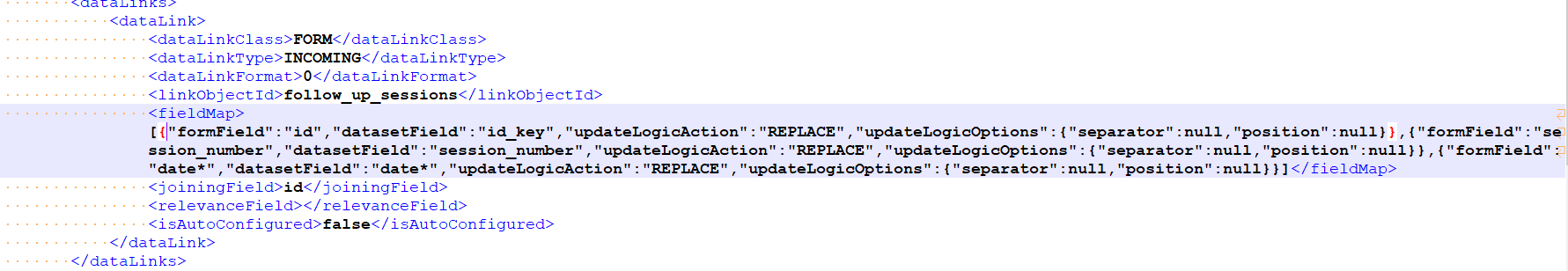

    how to view the line separately where curly bracket are used
    8 Posts 3 Posters 797 Views
    • AbdullahAlAminA
      AbdullahAlAmin
      Hello, I’m a newbie using this, so the words I use here might not express the way it should goes.
      So, under the fieldMap the object are separated by curly bracket (first one is red color, I know you can identify but I’m just making sure that my message make sense). I want to see the text within each brackets in a separate line, that way I’ll be able to identify each object for editing.
        PeterJones @AbdullahAlAmin
        @mynameinvein ,
        Interesting: you’ve got JSON embedded in your XML. (“You got XML wrapped around my JSON!” “Two great tastes that taste great together.” – With apologies to Reese’s.)
        If it’s just in that one place, and you have the JsonTools plugin installed, you could copy the contents of the fieldMap into a new tab, Plugins > JsonTools > Pretty-print current JSON file; or, if you have JSON Viewer plugin installed, then Plugins > JSON Viewer > Format JSON is equivalent. With either of those plugins, you could either copy the JSON entry into an empty file, format it, then copy it back into your XML, or you could just select the JSON inside the XML and then the plugin will just pretty-print the selected text. (Just don’t try to run those JSON pretty-print commands in the XML without a selection, as who knows what horrors they would inflict on the XML itself.)
        If you’ve got that a lot, then you might be able to get a regular expression to be able to do some pretty-printing of the embedded JSON, though it won’t be as good as a true JSON-enabled pretty-printer would do. Normally, I would warn against regex for JSON or for XML. But when you’ve got the two mixed, no one tool is going to be able to handle your needs. And in your case, you seem to have the <fieldMap>...</fieldMap> as a consistent wrapper, so it might work in these limited situations. To do this, you would have to use at least one (and maybe two) of our generic regex formulas – specifically, replace in a specific zone, with the start-of-zone (BSR) being <fieldMap, end-of-zone (ESR) being </fieldMap; to keep things simple, it would be easiest (but not perfectly pretty-printed) to set your text-to-replace (FR) to { and your replacement-text (RR) to \r\n\x20\x20\x20\x20\x20\x20\x20\x20\x20\x20\x20\x20\x20\x20\x20\x20\x20\x20\x20\x20{ – that would at least come close to what you want. (I used \x20 to indicate spaces, because that works better in the Forum for you to copy/paste; in the regex, you could use either \x20 or the literal space character for each of those to do the indentation.)
        AbdullahAlAminA 1 Reply Last reply Reply Quote 4

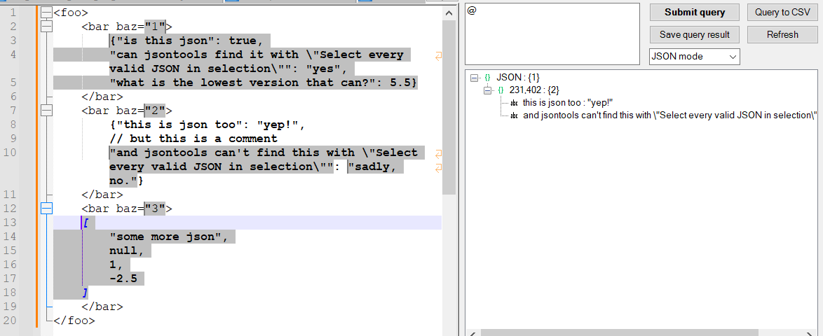

          JsonTools version 5.5. or newer has a Select every valid JSON in selection command that you might find useful.
          However, while JsonTools can handle comments and many kinds of errors in general, it cannot parse JSON with errors when that command is running. Here’s an example:
          and here’s the text of that file, so you can experiment with it:
