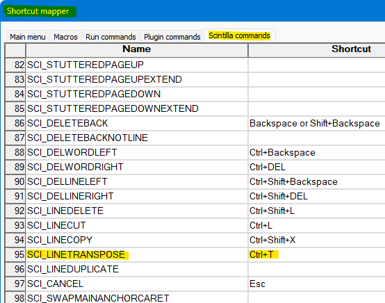

        where this shortcut that exchanges lines is mentioned? Not in settings> shortcut mapper
        It IS in Shortcut Mapper:
        you can search in the filter write “ctrl+t” it doesn’t show up
        That’s because something like ctrl+t doesn’t do the filtering you want (maybe that’s why to you it is a bug?).
        A trick I use for quickly finding a shortcut is to try to assign it to a command that has no shortcut (but don’t go all the way through with the assignment). It will then exactly show you where the OTHER definition for that shortcut is, and you can cancel out of the new assignment.

          @Alan-Kilborn Thank you very much! Now I can have a much better idea of the shortcut mapper. You are correct and I agree with all what you said. I used the technique you mentioned, it’s great.
          I have these new ideas though:
          -It seems, unlike all the other tabs on the shortcut mapper, that the “scintilla” tab doesn’t show as results in the “filter” search when I write “ctrl” for example. This is an unexpected inconsistency: the majority of users (not as savvy as you) will get stumped by it. Do you agree or is there a good reason why the filtering should remain like this?
          Edit: Now I’m reading the user manual, it turns out scintilla shortcuts are complex. I’ll send you another message after my investigation.
          Edit2: I will maybe submit a bug about one of my aspects talked by us before: scintilla shortcuts not appearing in filter search, since I created an alternative one with “ctrl+shift+L” (doesn’t matter) for one scintilla command (doesn’t matter which), and I searched with the filter for “ctrl” and it DID appear! That means maybe this is not intended, they are supposed to appear.

                    Also, filtering for Ctrl+T works in the shortcut mapper. There is an irritation in that the filter results are only for the current tab meaning you need to flip through all the tabs using the mouse as there do not seem to be keyboard actions that let me flip through the tabs. Ideally, the filter thing would show the results for all tabs.
                    Also, you need to type out the characters C t r l + T in the filter box and can’t do it via just a Ctrl+T on the keyboard to see what Ctrl+T is mapped to. At least the filter is not case sensitive.
