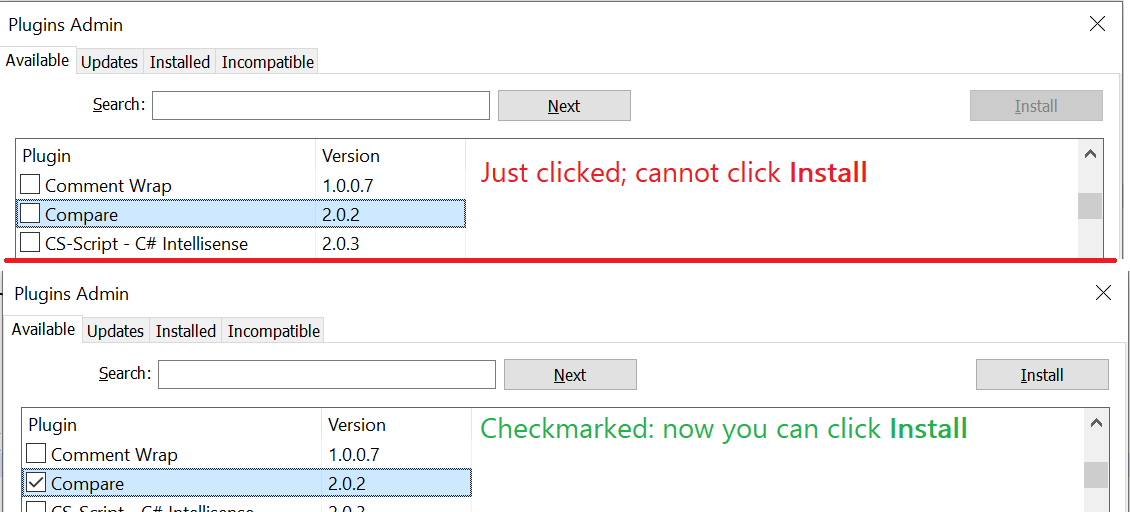

    Windows 11 64bit, not able to install compareplus plugin either by pluginAdmin or manually on NP++ v8.6. Please help !

      • opened PluginAdmin, I could see both compare and comparePlus plugins listed, but the install button is disabled or not clickable.

      • PeterJonesP Online
        PeterJones @vnuta9
        @vnuta9 said in Windows 11 64bit, not able to install compareplus plugin either by pluginAdmin or manually on NP++ v8.6. Please help !:
        Did you click the checkmark first? In Plugins Admin, you have to have the checkbox checked before Install will be clickable.

        To sum up:
        • You must checkmark the checkbox, not just click on the name, for Install to be available.

        • V Offline
          vnuta9 @PeterJones
          Oh my dear @PeterJones , how much dumb and distracted I should have been not to mind checking the check box. Yes, I am that dumb. It resolved the issue. Thanks for painstakingly respond to my post. Appreciate your help a lot.
              Don’t feel too bad. Someone else had the same experience recently.
              In fact, that’s come up often enough that I just pushed an update to the npp-user-manual.org website, in the so the Plugins Admin screenshot now explicitly shows the checkmark there, and the description paragraph explicitly describes the difference between just clicking on the plugin name (which only shows the description) and checking the checkbox (which enables the Install button to install that plugin)
