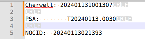

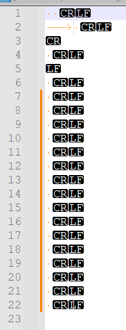

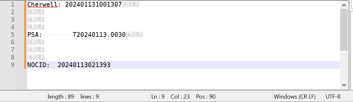

      When I am copying text into a NP++ document, I start with this text:
      and then I run ‘Remove Empty Lines’ or ‘Remove Empty Lines (Containing Blank Characters)’
      and end up with this:
      Why does the ‘Remove Empty Lines’/‘Remove Empty Lines (Containing Blank Characters)’
      not get rid of those remaining CR|LFs in the text (the remaining empty lines)?
      How would I go about getting rid of those as well?

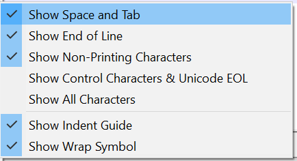

        What is your View > Show Symbol settings:
        Perhaps you don’t have the non-printing characters or control-characters visible, and lines that you think are empty actually have invisible/zero-width characters.

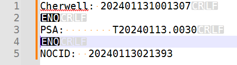

        For example, I was able to replicate your results by using Ctrl+Shift+E to put an ENQ character on lines 4 and 8. If I have Show Control Characters & Unicode EOL unchecked, I can replicate your second image after the remove-empty-lines:
        This is because View > Show Symbol has

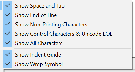

        If I change to checkmark showing control characters, then I see them:

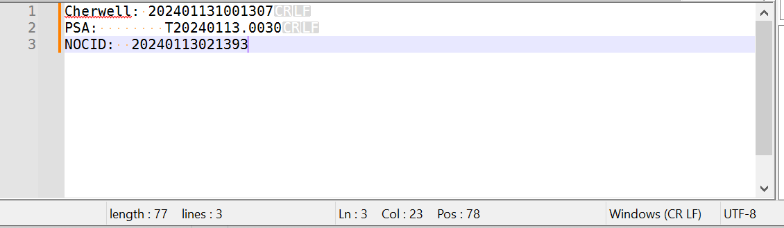

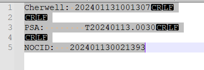

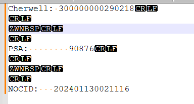

          OK, first thing, I was using a pretty old version of Notepad++ that didnt allow me to see some of those CRLF characters correctly, that was my first problem. Here is the newest version of my initial screen:

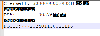

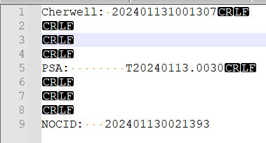

          Now, when I do the ‘Remove Empty Lines (Containing Blank Characters)’, I am left with:
          So, it is the ‘ZWNBSP’ character that is my problem here, I would think.
          Now, armed with that information, I am seeing some talk in the NP++ forums about just that subject…so I am hoping that maybe I can find some more information about the issue.

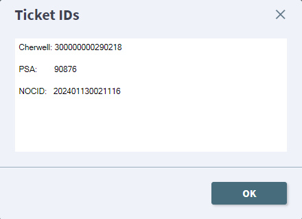

              I wish I could change the source of that text that I am copying, but it comes from our ticketing system and I just bring up a window that has all of the ticket number information
              then copy all of the text, and paste that into my NP++.

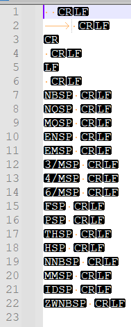

                        I came up with:
                        FIND: (?![\r\n\t\x20])(?:\s|\x{feff})
                        REPLACE WITH: nothing
                        This converts the following file:
                        into:
                        I just looked up the Unicode “Space Separator” category and put them all in that document, plus ZWNBSP, which is not categorized as a “Space Separator” and so has to be special-cased in the regex.
