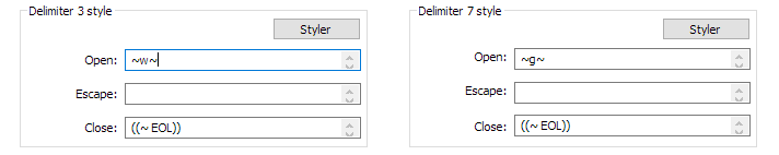

        @firedihm Change the closing delimiter to just ((EOL)) and add “Delimiter 3” to the nesting of Delimiter 7.
        F 1 Reply Last reply Reply Quote 1

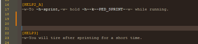

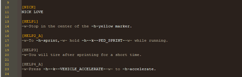

          @supasillyass thanks for the suggestion, but looks like nesting is also not the best solution
          Header [ ] highlighting breaks. That’s probably because [HELP2_A] has level 5 nesting, so it would need to encounter 5 ((EOL))s to properly exit.
          Simply inserting newlines helps resolve this, but it makes file look stupid
