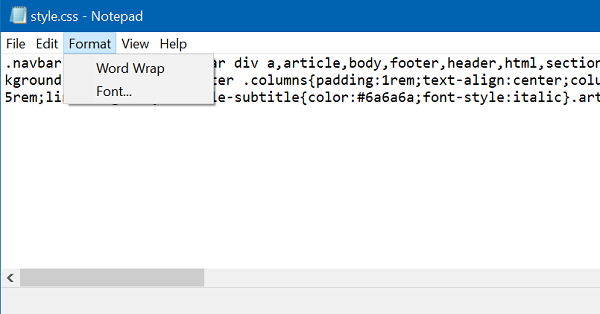

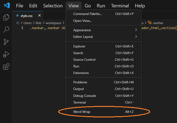

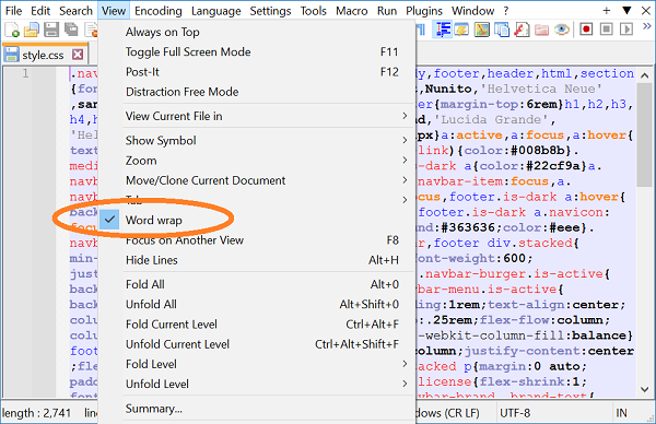

        Click View on the option menu, find Word wrap, and remove the ✅ (check mark) if it’s visible:
        Note that file contents are not altered by word wrapping; the line breaks are only visual.
        By default, MS Notepad and VS Code do not have wrapping enabled — although the Notepad version on my system (10.0.19045.3930) does appear to wrap lines after a certain limit:

          I tried the above solution and it works perfectly. Nicely explain with screen shot.Thank you so much for your help. Really grateful.
