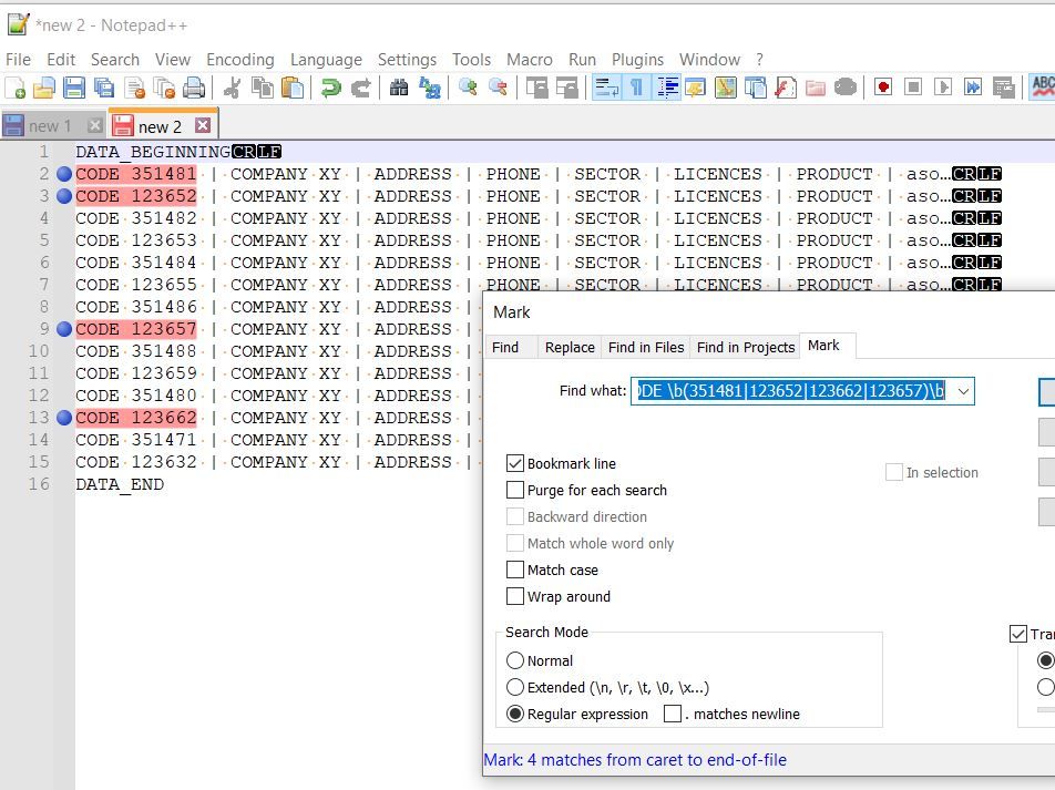

        Yes, although you will need to create a regular expression from the list to mark all the lines and you could then quickly verify the process marked the number in the correct location before deleting them.
        The regular expression would look like this:
        Find what:CODE \b(351481|123652)\b
        Use the Mark function and tick bookmark lines. The search mode is regular expression. Click mark all.
        Since the code numbers appear to be 6 digits and we have 500 if them you will have to do it in a couple of runs since the find what field has a character limit below the length you need. Hopefully you can see that to add more numbers you just put a vertical bar between each number and they all must be inside the () characters.
        Does that sound like something you could try, even if you just tried it with a couple of numbers first.

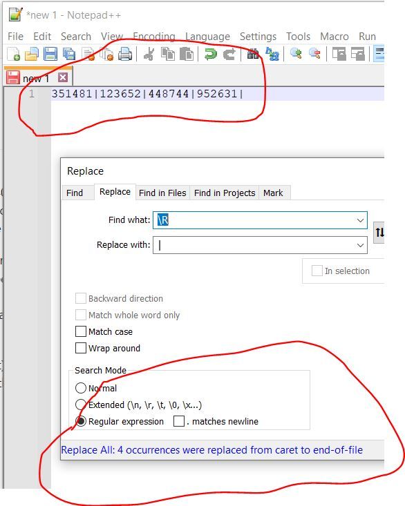

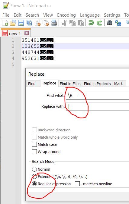

          So if your text file with the codes to be deleted looks like my first image below (the CRLF is the end of line marker, made visible by using View, Show Symbol, Show “end of line” or “show all characters” then you can easily make up the regular expression as I showed it.
          Make sure the cursor is at the start of the first code. Use the Replace function to enter into the following fields (search mode is regular expression):
          Find What:\R
          Replace With:|
          Click on Replace All.
          Now since you will have more characters than can fit into the Find What field you need to break it into 2 roughly equal sized portions. So as long as you don’t exceed 2046 (I think that’s about the maximum number) you will be fine, but easier to just pick 1750-1800 characters in length which should make 2 equal portions. The portion starts with a digit and ends with a digit, so you will need to remove one | when you break it into 2 portions.
          Copy the first portion over top of the example numbers I showed in the first regular expression. Tick bookmark lines and click on Mark All. You will get blue circles alongside each line with one of the codes numbers you are looking for (see another of my images below). You may want to spot check that all seems good. Once confirmed you can delete these marked lines by right clicking on one of the blue cirlces and selecting Bookmark, remove bookmarked lines. Or use the menu option Search, then Bookmark, remove bookmarked lines.
          Repeat the process for the 2nd portion of numbers. Your file should now be clear of any of those unwanted code numbers.
