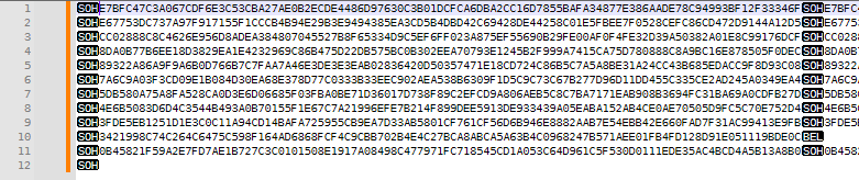

        • Mark OlsonM Offline
          Mark Olson
          The above answer (randomize line order) may not be what you’re looking for, because it sounds like you want to randomize the order of groups of lines.
          I have a series of operations that should be able to do that for you.
          Before you begin, make sure to check Regular expression in the find/replace form.
          Then search for \x07|\x01 in your document, and make sure your document doesn’t contain any of either of those characters. It shouldn’t, but if it does, try using different control characters (other than \t and \r and \n) in the regular expressions below. For example, if your text contains \x07 but not \x01, you might use \x02 instead of \x07.
          1. Find (?-s)^(.*)(\R(?!\1)|\Z) and replace it with ${1}\x07${2}
            • this will mark the end of each section of identical lines with a BEL character, which is not found in normal text.
          2. Find (?<!\x07)\R and replace it with \x01
            • this will replace all newlines inside of each section with the SOH character, which is also not found in normal text.
          3. Run the Edit->Line Operations->Randomize Line Order command from the Notepad++ main menu.
            • this randomizes the order of the sections.
          4. Find \x01 and replace it with \r\n (or \r if you use CR newlines, or \n if you use Unix newlines)
            • this restores the newlines within the sections
          5. Find \x07 and replace it with nothing.
            • this removes the \x07 we used to indicate the ends of sections.

                  • PeterJonesP Online
                    PeterJones @Benhur Marxs
                    @Benhur-Marxs ,
                    Because your data isn’t very precise, and because English appears to not be your first language, people are having a hard time understand what you actually want.
                    I am hoping that @Terry-R’s most recent reply will work for you. But if it does not work for you, the please follow the instructions below:
                    Instructions:
                    It might help if you gave better example data that actually has the multiple rows. But, instead of using 10/25/15/50, just use smaller numbers of rows, like 2/4/3/5. But show all the rows.
                    • Hit reply on this post.
                    • type **BEFORE:** and ENTER.
                    • Hit the </> button.
                    • Replace code_text with better example data of what your data is starting like.
                    • Go to the end of the reply.
                    • Hit ENTER a couple of times.
                    • type **AFTER:** and ENTER.
                    • Replace code_text with the “after” data that you want it to transform into.
                    Benhur MarxsB 1 Reply Last reply Reply Quote 2
                    • Benhur MarxsB Offline
                      Benhur Marxs @PeterJones
                      @PeterJones ok sorry is very clear now : i tried to reply as you suggest but the system blocking my reply as spam ! maybe need a point of reputation !
                      maybe must download from here link text
                        @Benhur-Marxs ,
                        Probably akismet thinks the random nonsense in that text is spam, which repuation wouldn’t help you with (and you already have reputation).
                        Looking at the paste bin, I don’t actually think you want randomization of the order. You just seem to want each group of identical lines to be re-ordered, so that the group of 1 identical line goes first, the group of 2 identical lines goes second, etc – so sorting by number of identical lines that happen in a row.
                        If so, then have you tried @Terry-R 's most recent solution – because his description of that solution (sorting by frequency) seems to be exactly what your paste-bin implies.

                        Benhur MarxsB 1 Reply Last reply Reply Quote 1
                          @PeterJones … no luck ::: is still not sorted as i asked !! still casual random !
                          But no problem friend , thank you for your answer !
                          PeterJonesP CoisesC 2 Replies Last reply Reply Quote 0
                            @Benhur-Marxs said in How to randomize lines on repeat order:
                            If the data really has the <-- 3 times and similar, then @Terry-R’s procedure won’t work. If your data does not have the extra information at the end, it works exactly as described, as I show below.
                            So, from the data I showed in my post, if I remove the <-- #... from the end of those lines (so that there are no spaces or other characters beyond the end of the main line), and then follow the procedure, and I get:
                            1. Original
                            2. Mark sections with BEL
                            3. newline to SOH
                            4. initial SOH
                            5. add # repeatedly until no more are added:
                            6. standardize EOL (not show, no change)
                            7. sort
                            8. BEL to CRLF
                            9. removes # lines
                            10. Removes empty lines
                            And done.
                            • CoisesC Online
                              Coises @Benhur Marxs
                              @Benhur-Marxs
                              Try this. All Find what / Replace with below are entered in the dialog that comes up when you select Search | Replace from the main menu; in addition to entering the find and replace strings, you must have Search Mode: Regular expression set and Wrap around checked.
                              Find what : ^
                              Replace with : @#
                              Click Replace All.
                              Find what : ^(@++)([^\r\n]++)\R(@++)\2$
                              Replace with : \1\3\2
                              Click Replace All repeatedly until the message at the bottom says no more replacements were made.
                              Edit | Line Operations | Sort Lines Lexicographically Ascending
                              Find what : ^(@+?)(\1@?)(#[^\r\n]*+)$
                              Replace with : \1\3\r\n\2\3
                              Find what : ^@#
                              Replace with : (empty)
                              Click Replace All.

                                • guy038G Offline
                                  Hello, @benhur-marxs, @terry-r, @mkupper, @peterjones,@coises and All,
                                  Here is an alternate solution :
                                  • From the original INPUT text, below :
