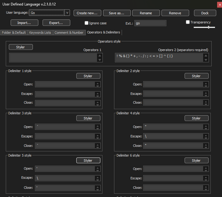

            More testing. These seems to be something broken with UDL. If I remove the Delimer style 1 and copy it to Del. style 4, it starts to work.
            Similarly, if I do the same for Operators 1 to Operations 2 it works for everything except for last line characters/ It looks like brackets really are not operators and perhaps their is a better section for them? But that is where all the UDLs are putting them

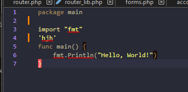

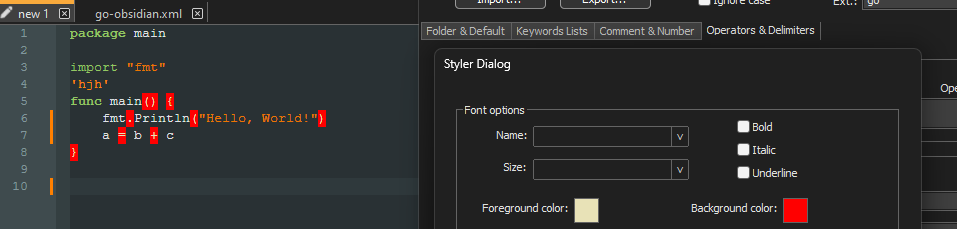

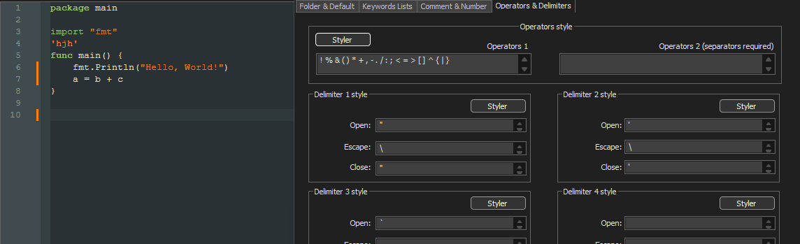

                    This is as close I I could get it to working. Have not even tested with much code, so their might be more broken keywords.
                    The “Operators 1”, “Delimiter 1 and 2 style” text boxes seems to be bugged, as just copying their contents over to later text boxes fixed many issues.
                    It looks like the remaining issue with the “{” and “)” characters is just that they are the last character on a line. Maybe that is just a limitation of Operators? Brackets are not really operators, but that is where everyone putd them, and operators should be able to work over multiple lines so I don’t know.
                    Screenshot 2024-01-07 142217.png Screenshot 2024-01-07 142234.png image url)
                      Nope, they work just fine as the last character of a line as well. In the screenshot you are showing, your caret is on one of the matched-pair, so it’s highlighted as “brace highlight style”, which is what Notepad++ uses for showing you () and {} and [] pairs; if your caret were elsewhere, it would be showing in your operator style.
