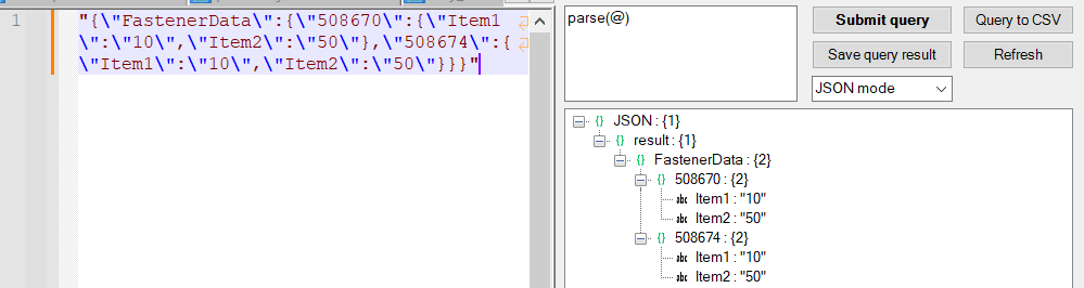

            It looks to me like your JSON is a JSON string representation of a JSON array. This means that the parse() RemesPath function (follow that link, then find the parse() function) will help you. It attempts to parse a JSON string, and returns an object that either has result: (the result of parsing) or error: (the error that caused parsing to fail). Note that this function was added in a pretty recent version (v5.5.0), so you might want to get the latest version if that query fails.
            Here’s an image of what we get with your JSON.
            As you can see from the treeview on the right, the parse() function worked. Since we know it’s successful, I’ll just change the query slightly, to parse(@).result (which extracts the result value). Now I just click the Save query result button above the tree, and the parsed array is saved in a new buffer. The contents of this buffer will be as follows:
