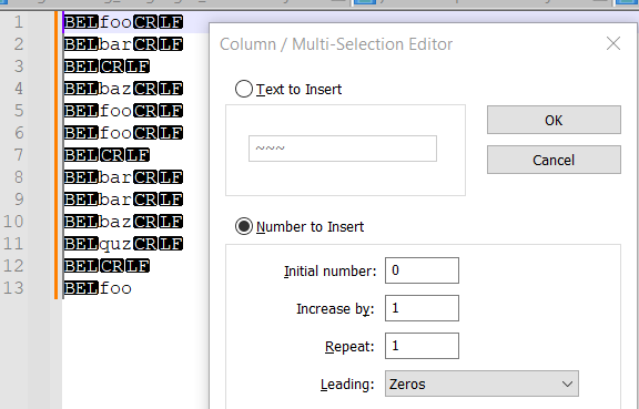

                          @guy038 proposed a very simple solution to this, but I have a multi-step solution using no plugins, without having to perform the same find-replace multiple times in a row:
                          Make sure Regular expressions are ON in the find/replace form before starting this.
                          The document starts looking like this:
                          foo
                          bar
                          baz
                          foo
                          foo
                          bar
                          bar
                          baz
                          quz
                          foo
                          1. Use the find/replace form to replace ^ with \x07. This adds a BEL character (convenient because it does not show up naturally in most text documents) to the beginning of each line.
                          2. Make a column selection in the first column of every line of the file, then use the column editor to insert a number (with leading zeros to facilitate sorting). This numbers the rows, so they can later be put back in order.
                          3. Use the find/replace form to replace (?-s)^(\d+)(\x07)(.*) with ${3}${2}${1}. This puts the column numbers after everything else.
                          4. Use the menu command Edit->Line Operations->Sort Lines Lex. Ascending Ignoring Case. Now all the lines with the same text are grouped together, and a single regex-replace can get rid of all but the first line with given text.
                          5. Find/replace (?-s)^(.+)\x07\d+(?:\R\1\x07\d+)* with ~~~~${0}. This marks the first instance of each line, so that it won’t be deleted later. Note that the ~~~~ in this example should be replaced with some other text that occurs nowhere in your document.
                          6. Find/replace (?-s)^(?!~~~~).*(\x07\d+) with ${1}. This clears the text but not the line number of any line that does not have the first instance of its text.
                          7. Find/replace ^~~~~ with nothing. This removes the starting marker.
                          8. Find/replace (?-s)^(.*)(\x07)(\d+)$ with ${3}${2}$1. This brings the line numbers back to the front so that the lines can go back in order.
                          9. Use the menu command Edit->Line Operations->Sort Lines Lex. Ascending Ignoring Case. Now all the lines are back in their original order.
                          10. Find/replace ^\d+\x07 with nothing. This removes the line numbers and separator.
                          Finally, you are left with the original document with the non-first instances of each line’s text replaced with nothing! A lot of steps, but every step is highly scalable and won’t exhibit bad performance on very large files.
