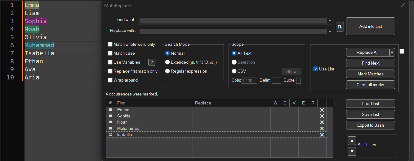

            As already explained, you can use Regex for this purpose, or you can use MultiReplace Plugin you can install via Plugin Admin to generate a list of names for masking all at once. Alternatively, you can select the names separately in the list to search for them.cd8823a1-71d0-4c3b-a34b-95a6b6e2f0bd-image.png
