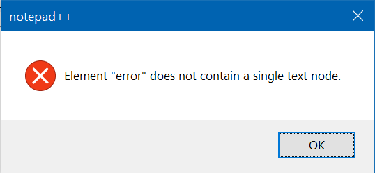

      I’ve recently installed Xdebug and the Npp Dbgp plugin following the instructions. Calling xdebug_break or xdebug_info in the PHP CLI, the connection is established with the Npp IDE which immediately throws up a a message
      Unable to map remote: file//C:/PHP php shell code (ip: 127.0.0.1 idekey:  local_setup) fallbeck to source
      The PHP CLI waits until the message is acknowledged, when it comes back with a command entry prompt (following the xdebug_info output), and the Npp IDE throws up an error message
      Element "Error" does not contain a single text node.

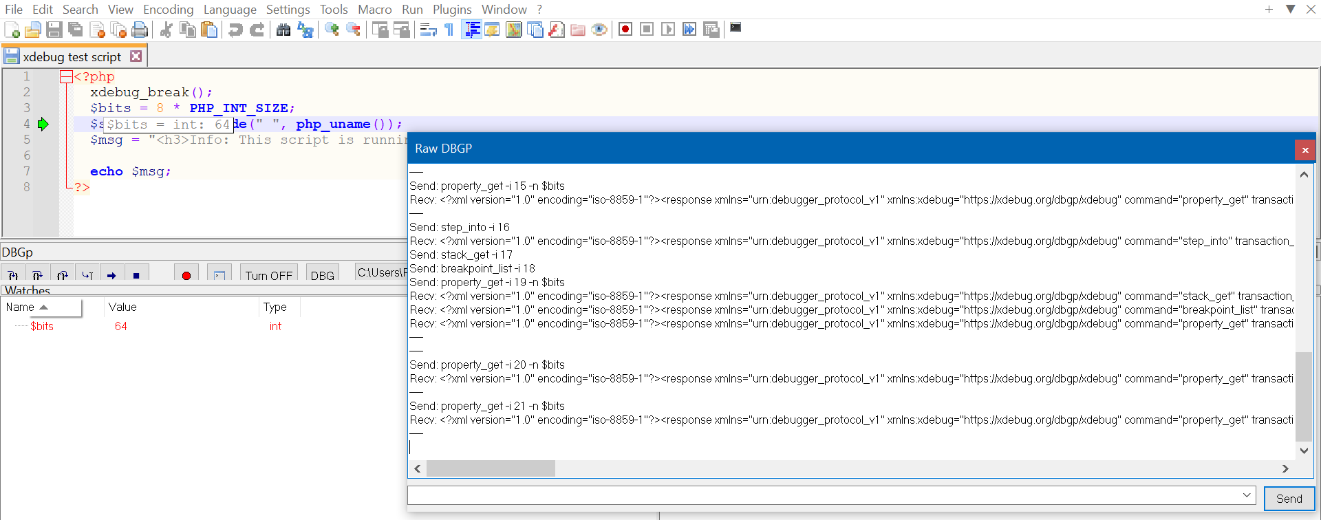

      The same happens when xdebug_break is called from within a function in a script ( even the file name in the first message is unchanged), and script execution continues. All, breakpoints and watches are ignored.
      Setting/unsetting the ‘Use SOURCE command…’ and/or the ‘Break at first line…’ options in the Dbgp config don’t have any affect.
      Is this a bug, or am I doing something wrong?

          From your information I think the issue is how Xdebug or the plugin is configured (or both). It works for me, but I’ve only ever used it on very trivial scripts:
          In my PHP’s conf.d folder, I have this (and only this) in xdebug.ini:
          [xdebug]
          xdebug.mode=debug
          error_reporting=E_ALL
          force_display_errors=1
          All of DBGp’s options are in the default state. In fact there is currently no dbgp.ini in $(NPP_DIR)\plugins\Config. Try removing any INI file you may have in your config path first.
          Also keep in mind that the plugin can only communicate with Xdebug in a single-byte encoding (such as ISO-8859-1, as the Raw DBGp dialog is showing in the screen capture above). Click the DBG button on the plugin’s debugger panel while the server is connected and make sure the output is readable. If it looks like nonsensical Chinese, then Xdebug is most likely sending requests in UTF-8. That should not be the case in the default operating mode, so I suggest clearing out any custom configurations.

            [17192] [Step Debug] <- source -i 1 -f file://C:/PHP/php shell code
            [17192] [Step Debug] -> <response xmlns="urn:debugger_protocol_v1" xmlns:xdebug="https://xdebug.org/dbgp/xdebug" command="source" transaction_id="1"><error  code="1"><message><![CDATA[parse error in command]]></message></error></response>
            O.K., I get an error response if I just enable [ ] SOURCE command for all files and bypass maps in the config menu:
            Note that in my setup there’s no Xdebug server up and running; I just have PHP configured to load php_xdebug.dll whenever I invoke the preprocessor.
            No problems when [ ] Break at first line . . . is enabled. Just disable the “SOURCE command …” option and see what happens.
