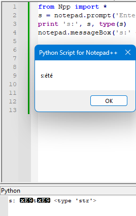

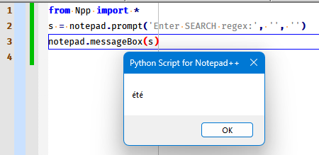

      …but… what is the real issue you are experiencing with this?
      Meaning, \xe9t\xe9 really is été, it is just expressed differently when you view it a certain way. So there’s no loss of data…so I’m just wondering why this is a problem for you?
      For example, here’s two ways to view it; one shows what I presume you want to see, and one shows what your complaint was about:
      It’s chopped off in the screenshot, but the msgbox’s argument is 's:' + s.
      • guy038G Online
