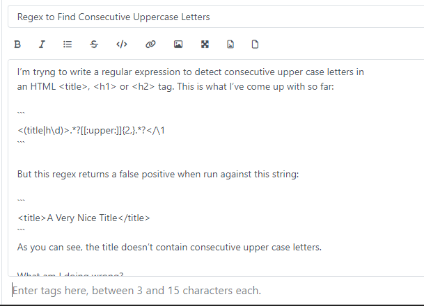

      I’m tryng to write a regular expression to detect consecutive upper case letters in
      an HTML <title>, <h1> or <h2> tag. This is what I’ve come up with so far:
      <(title|h\d)>.*?[[:upper:]]{2,}.*?</\1
      But this regex returns a false positive when run against this string:
      <title>A Very Nice Title</title>
      As you can see, the title doesn’t contain consecutive upper case letters.
      What am I doing wrong?
      (FYI, the forum software won’t let me scroll down to the field where I would enter tags.)
        The “tag” feature on posts is rather irrelevant – I doubt anyone actually uses them when reading the forum to answer, and I would be surprised if anyone bothered when looking for previuos conversations here (in my eight years as a regular of this forum, I’ve never found the tags useful)
        Besides, as far as I know, you don’t have to scroll. You just click where it says “Enter tags here, between 3 and 15 characters each”, and start typing, and that’s how you enter the tag.
