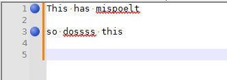

            By the way, the blue bullet in front of the lines with miss-spellings has changed to a green perpendicular line. Is it the same in your version?
            I still see bookmarks as the blue bullet.
            The green perpendicular line means “this file has been saved since the last changes to these lines”, and it will change to orange (like in my screenshot) if there have been changes since the last save (or in my case, if it’s a new file that’s never been saved before).

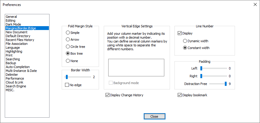

            • Check to make sure Settings > Preferences > Margins/Border/Edge has ☑ Display Bookmark checkmarked. (large screenshot at end of post)

            • Try re-running Plugins > DSpellCheck > Additional Actions > Bookmark Lines with Misspelling . If you have misspelled words, they should have squiggles and a blue bullet indicating the bookmark.
            If you don’t see the blue bullets after those checks, take a screenshot and paste it in your reply here.
