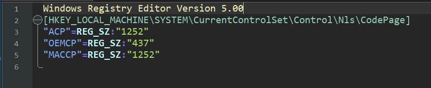

      Opening a .reg file for the first time did get syntax highlighting which resembled CSS a bit, although it did not present clearly in a dark theme, changing it to another language and then back to Registry ended up with no or “none” highlighting.

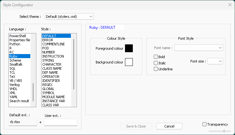

      In Stylers.xml there is a language “Register”, no “Registry” - would that be the cause?

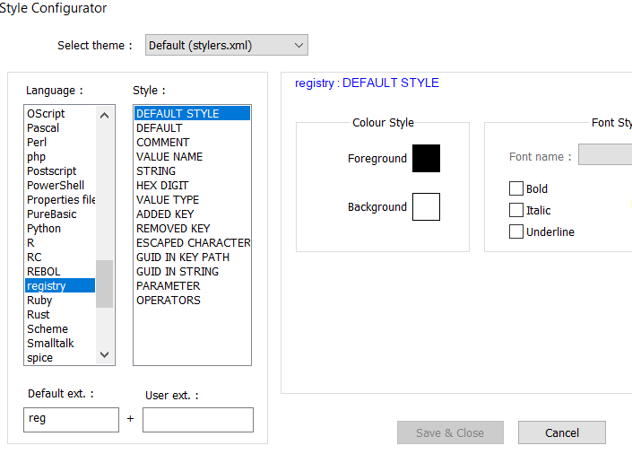

        Possibly. In my stylers.xml file (looking thru the GUI) I see
        When I open the stylers.xml file (from %appdata%\Notepad++ folder) I see a lexer which references this line. Note it has no extension as I didn’t have a “user ext.” added.
        Quite possibly you have a corruption in this file at this location. If you look at the same file in the installed folder (where Notepad++ resides), so either “Program Files” or “Program Files x86” you might see the content referring to the “registry”. If so then consider copying this file over top of the one in the %appdata%\Notepad++ folder. Bear in mind that any alterations you have done in the style configurator will be lost, so the other option will be to copy just the relevant lines from the good stylers.xml file to the bad file.

          Highlighting will appear only if the active theme has assigned styles to the particular file type. At the moment, only 3 themes assign styles to Registry, not counting “Default (stylers.xml)” :
          $ git grep -li 'name="registry"' -- PowerEditor/installer/themes | awk -F '/' '{print $4}'
          DarkModeDefault.xml
          Deep Black.xml
          Zenburn.xml
          So, you will have to choose “DarkModeDefault”, “Deep Black” or “Zenburn” to get styling in Registry files. Or try a third-party theme that covers a wider range of file types, e.g.,

            The Stylers.xml in Appdata is dated 26/01/2023. Using the cloud, so it’s the same. The langs.xml file is dated 2016 - same with you?
            Also, no REBOL language in there either, mine must be old,
                Your langs.xml is 7 years out of date.
                there are files stylers.model.xml, langs.model.xml and contextMenu.xml in Program Files all looking larger and newer than the ones above
                Correct, the installer does not update your copies of the non-model files, because it might delete customizations you’ve made, which would annoy users who have customized.
                If you haven’t customized any of your stylers, language keywords, or context menu, then you can safely delete the versions in %AppData%\Notepad++ and the next time you run Notepad++ it will re-create those files from their defaults.
                If you have customized those, then I would suggest using the ComparePlus plugin to compare %AppData%\Notepad++\____.xml to C:\Program Files\Notepad++\___.model.xml, and bring across anything from the .model.xml that doesn’t clobber your customizations.
