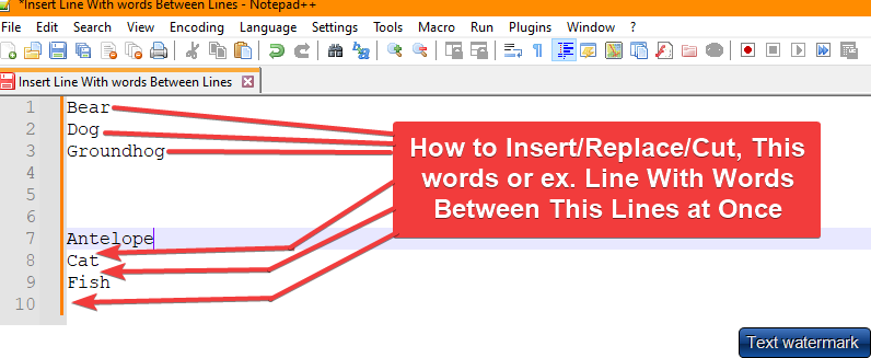

      I want to Insert/Add/Cut&Paste Multiple line of Words between the lines at once, How do I get that done?
      1. The Case;

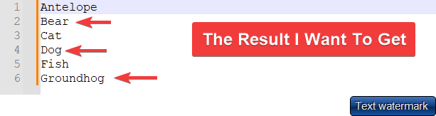

      1. What I want to get;

        I think you do this using the find-and-replace (CTRL+H)
        Find what: \r\n\r\n
        Replace with: \r\n
        The \r is the CR=carriage return character (ascii 13) and \n is the line feed (ascii 10). So this replaces a double <cariage return><line feed> (=empty line) with one single <cariage return><line feed>.
        Under Search mode be sure that “Extended” is selected. Btw this also depends on the newline type file of your type, see bottom right in Notepad++, Windows=CR/LF or for Unix=LF.
        And for sorting, you can go to the menu Edit -> Line operations -> Sort Lines Lexicographically Ascending

          The assumption, based on your example data, is that you want to sort. If that’s the case, then follow the advice already given (though I’d say sort first, then Edit > Line Operations > Remove Empty Lines rather than trying to do it as a search/replace).
          However, if what you really want is to interleave lines , I would suggest making use of Column Editor and sorting.
          … and as I was writing up the instructions, the original post was deleted. It is considered exceedingly rude to delete a post after there is at least one reply to it. As such, a moderator has undeleted your post.
          The general procedure would have been something like "column select from the first line of the first group to the last line of the first group (Edit > Begin/End Select in Column Mode being your friend, if you don’t want to just use Alt+Click+Drag), then Edit > Column Editor (Alt+C), Initial Number=2, Increment By=2; similar with the second group, except Initial Number=1 – this makes the first group 2/4/6/… and the second 1/3/5/… Then use lexicographical sort. Then use column select again and delete the numbers (or use a regex like ^\h*\d+\h* and replace with nothing) …
