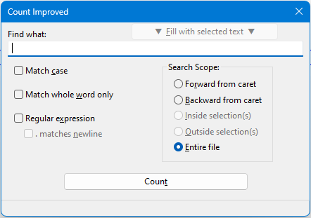

      Needless to say, I disagree so I’ve created what I think is a better match-counting solution via script. In this version, called “CountImproved”, I fixed the problems that I noted and added some new ways of counting, which Notepad++'s Count can’t do, specifically:
      • counting outside of the selected text
      • counting inside/outside multiple selections
      • counting inside/outside a column-selected block of text
      For the script’s user interface, I utilized the Little Dialog Wrapper and arrived at this, which should be self-explanatory for anyone that has used Notepad++'s stock counting interface:
      Here’s the script listing for CountImproved.py:

      class CountImprovedDialog(Dialog):
          def __init__(self, title='Count Improved'):
              super().__init__(title)
              dlgw = 250
              self.size = (dlgw,147)
              self.center = True
              self.status_bar = StatusBar('', size=(dlgw-1,12), position=(0,88))
              self.findwhat_label = Label('Find what:', size=(50,10), position=(5,5))
              self.findwhat_edit = TextBox('', size=(240,12), position=(5,14))
              self.fill_findwhat_from_sel_button = Button('▼  &Fill with selected text  ▼', size=(120,14), position=(105,0))
              self.fill_findwhat_from_sel_button.onClick = self.fill_findwhat_click
              self.matchcase_checkbox = CheckBoxButton(title='Match &case', size=(90,14), position=(10,30))
              self.matchwholewordonly_checkbox = CheckBoxButton(title='Match whole &word only', size=(90,14), position=(10,48))
              self.regex_checkbox = CheckBoxButton(title='Regular e&xpression', size=(90,14), position=(10,66))
              self.regex_checkbox.onClick = self.regex_click
              self.dotmatchesnewline_checkbox = CheckBoxButton(title='. matches &newline', size=(90,14), position=(18,78))
              gbx = 130; gby = 30
              self.scope_groupbox = GroupBox('Search Scope:', size=(90,77), position=(gbx,gby))
              self.scope_fwd_from_caret_radiobutton = RadioButton('Fo&rward from caret', size=(80,14), position=(gbx+10,gby+10))
              self.scope_bwd_from_caret_radiobutton = RadioButton('&Backward from caret', size=(80,14), position=(gbx+10,gby+22))
              self.scope_in_sel_radiobutton = RadioButton('&Inside selection(s)', size=(80,14), position=(gbx+10,gby+34))
              self.scope_out_sel_radiobutton = RadioButton('&Outside selection(s)', size=(80,14), position=(gbx+10,gby+46))
              self.scope_entire_doc_radiobutton = RadioButton('&Entire file', size=(80,14), position=(gbx+10,gby+58))
              cbw = 150
              self.count_button = Button('Coun&t', size=(cbw,14), position=(int(dlgw/2-cbw/2),114))
              self.count_button.onClick = self.count_button_click
              self.show()
