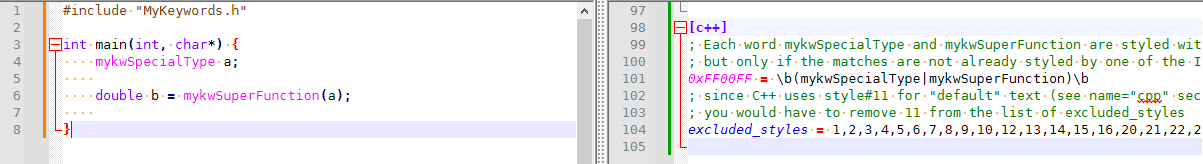

        Given your description, I think your best bet is to use the EnhanceAnyLexer plugin: with it, you can open a C++ file, use Plugins > EnhanceAnyLexer > Enhance current language, it will create a [c++] section in its configuration file that will start something like this:

        You could then define a new foreground color (maybe bright pink #FF00FF) for your list of keywords, and use a regex to give the list of keywords. For example, if you had keywords mykwSpecialType and mykwSuperFunction, you could create a regex that finds text that matches either (with a word boundary on each side, so that mykwSpecialType would not match TommykwSpecialTypeHere):
        [c++]
        ; Each word mykwSpecialType and mykwSuperFunction are styled with the color 0xFF00FF,
        ; but only if the matches are not already styled by one of the IDs in excluded_styles.
        0xFF00FF = \b(mykwSpecialType|mykwSuperFunction)\b
        ; since C++ uses style#11 for "default" text (see name="cpp" section of stylers.xml)
        ; you would have to remove 11 from the list of excluded_styles
        excluded_styles = 1,2,3,4,5,6,7,8,9,10,12,13,14,15,16,20,21,22,23
        If you have more keywords, just use more |anotherKeyword in the alternation list in that regex.
        My guess is that this will come the closest to what you want: it will keep all the benefits of the C++ lexer, but allow you to define one or more new style categories, where you get to define the desired extra keywords and their foreground color.
