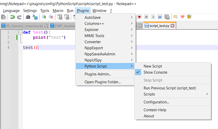

                                Can you show a screenshot of the Plugins > Python Script menu, showing the checkmark really is on the Show Console entry?

                                  @Fuel-DZN
                                  Can you take the same screenshot but with the whole npp window?

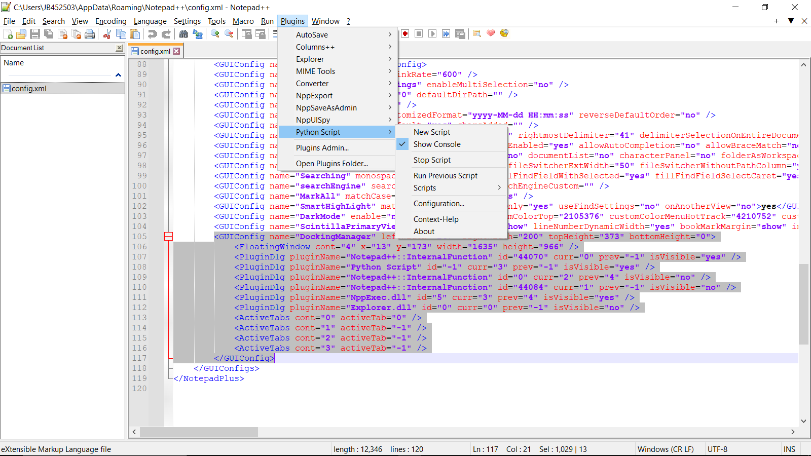

                                    @Ekopalypse said in Pythonscript plugin / console not working:
                                    @Fuel-DZN
                                    @Fuel-DZN ,
                                    While you’re at it, also File > Open %AppData%\Notepad++\config.xml , search for GUIConfig name="DockingManager" and then copy the DockingManager section from that file, paste it into your reply, select it and click the </> toolbar button in the forum edit-your-post window, which will make it look something like this in your post:
                                    <GUIConfig name="DockingManager" leftWidth="200" rightWidth="200" topHeight="200" bottomHeight="200">
                                            <PluginDlg pluginName="Notepad++::InternalFunction" id="42052" curr="0" prev="-1" isVisible="yes" />
                                            <PluginDlg pluginName="Notepad++::InternalFunction" id="44084" curr="1" prev="-1" isVisible="yes" />
                                            <PluginDlg pluginName="Notepad++::InternalFunction" id="44080" curr="3" prev="-1" isVisible="yes" />
                                            <ActiveTabs cont="0" activeTab="0" />
                                            <ActiveTabs cont="1" activeTab="0" />
                                            <ActiveTabs cont="2" activeTab="-1" />
                                            <ActiveTabs cont="3" activeTab="0" />
                                    </GUIConfig>
                                    That section will tell us whether the problem was, as I suspected, that you have just shrunk your PythonScript console panel too small for you to notice. (Please note, the FAQ I linked you to above already told you to go looking in that file, and told you how to reset that section so that it will likely fix your problem; given your lack of mention in your reply, I am going to assume that you didn’t notice that piece of advice from my previous post.)
                                    Fuel DZNF 1 Reply Last reply Reply Quote 3
                                      <GUIConfig name="DockingManager" leftWidth="247" rightWidth="200" topHeight="373" bottomHeight="0">
                                                  <FloatingWindow cont="4" x="13" y="173" width="1635" height="966" />
                                                  <PluginDlg pluginName="Notepad++::InternalFunction" id="44070" curr="0" prev="-1" isVisible="yes" />
                                                  <PluginDlg pluginName="Python Script" id="-1" curr="3" prev="-1" isVisible="yes" />
                                                  <PluginDlg pluginName="Notepad++::InternalFunction" id="0" curr="2" prev="4" isVisible="no" />
                                                  <PluginDlg pluginName="Notepad++::InternalFunction" id="44084" curr="1" prev="-1" isVisible="no" />
                                                  <PluginDlg pluginName="NppExec.dll" id="5" curr="3" prev="4" isVisible="yes" />
                                                  <PluginDlg pluginName="Explorer.dll" id="0" curr="0" prev="-1" isVisible="no" />
                                                  <ActiveTabs cont="1" activeTab="-1" />
                                                  <ActiveTabs cont="3" activeTab="-1" />
                                              </GUIConfig>
                                      (Indentation is messed up but I don’t know how to fix that.)
                                      I tried the FAQ suggestions which did not solve it.
                                      In case it is helpful, earlier I said:
                                      When when I activate it after opening n++ I see something very briefly flash but that’s it.
                                      • PeterJonesP Online
                                        PeterJones @Fuel DZN
                                        Do you see that bottomHeight="0" ? That is the culprit, and the FAQ explains how to fix it.
                                        Also, the up-down arrow in the right place would have fixed it also. This gap from your screenshot is exacty the gap I was referencing in the FAQ. I have added the arrow to show you where to hover your mouse cursor to find it.
                                        Fuel DZNF 1 Reply Last reply Reply Quote 2
                                        • Fuel DZNF Offline
                                          Fuel DZN @PeterJones
                                          @PeterJones Thank you, resizing the panel just fixed it. I don’t know why it didn’t work before.
