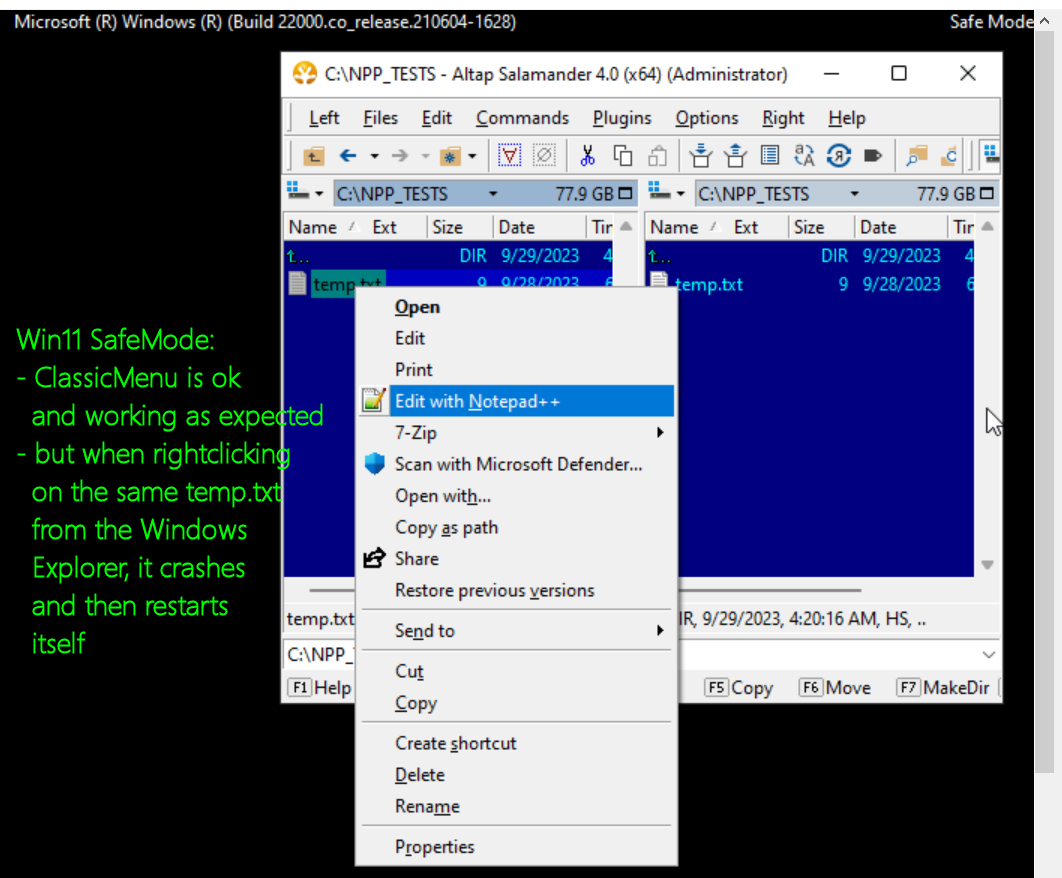

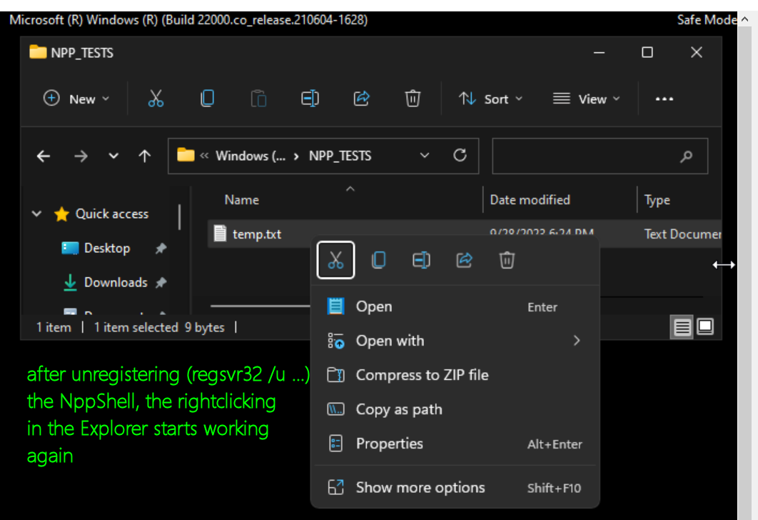

            xomx @imanubdesigner
            @imanubdesigner
            I can confirm the problem with N++ v8.5.7 x64.
            You should create a Github issue here: https://github.com/notepad-plus-plus/nppShell/issues
            (also with a link to this thread)

                @xomx understood the problem perfectly.
                The first context menu you have just right-click on an application, image, etc… I have an application in front of me, Display Driver Uninstaller, for example, I right-click on it and there is Explorer. exe crashes and has a refresh. As soon as you click again, the same thing again: infinite.
                @mkupper said in Notepad ++ Installation and Explorer.exe crash only in Safe Mode:
                @imanubdesigner and @xomx - I have posted this to github for Don Ho’s attention.
                mkupper, as soon as I right click explorer.exe crashes. I can’t even see “Edit with Notepad++” (no context menu appears, because explorer.exe crashes before I can see it). You should correct. Thank you! Very kind, mkupper.

                  The new installers which contain the fix of crash in Safe Mode is available here for testing:
                  http://download.notepad-plus-plus.org/repository/MISC/fixSafeModeCrash/
                  The binaries are signed. Could you test the binary of your choice and confirm if the crash has been fixed please?
                  I 1 Reply Last reply Reply Quote 4

                    I just got hold of the computer. Sorry for any delay. Yes, I confirm that the explorer.exe crash problem (a brutal refresh just after clicking the right mouse button) has been resolved. Now, when you right click, there is the usual Windows context menu.
                    Thank you!

                      I able to confirm that the old npp 8.5.7 (both x32 and x64) crashes Explorer when in Windows 11 Safe Mode and that both of the new npp 8.5.7 with the nppShell fix work in Windows 11 Safe mode and also seem fine in Windows 11 standard mode. I did not test the ARM version.
                      The crash with the old version was interesting in that when you right clicked on a file then Explorer.exe would quietly vanish instead of showing the right-click context menu.
