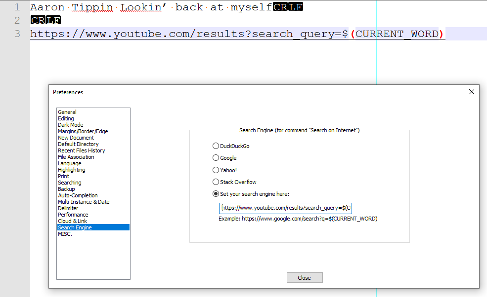

        Terry R @Dawn
        @Dawn said in Internet Search YouTube:
        Is there a way to search on YouTube for the selected word.
        Yes, if you look at the option to “change search engine” then type in (copy this text in red below):
        https://www.youtube.com/results?search_query=$(CURRENT_WORD)
        What you then do is to highlight the word(s) you want Youtube to search on, then use the Edit, On Selection, Search on Internet (see my image below).
        As for deleting a line where the cursor is currently, see Settings, Shortcut Mapper, Scintilla commands and then look for SCI_LINEDELETE. On my system it is Ctrl+Shift+L, that’s my shortcut key (hotkey) to delete that line.
