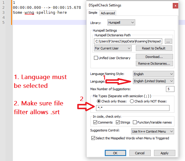

                That’s not the point. His point was “type a misspelled word, and make sure it’s marked as misspelled”. This helps you debug what’s going wrong. If typing wrng doesn’t show it as misspelled, then you have something not configured correctly; without it configured correctly, you cannot expect it to bookmark the lines that have misspellings. This was a simple test you could have done by just intentionally typing a misspelled word and seeing if it got properly marked as misspelled. That’s why he said “first things first” – it wasn’t going to solve your problem, it was just going to help with the debugging of your problem.
                My best bet for the problem you have described is that you either forgot to actually activate a dictionary after installing the DSpellCheck plugin, so it’s not finding any misspelled words; or you have it set so that DSpellCheck doesn’t check files with extension .srt . Both of these problems could be easily diagnosed if you went to Plugins > DSpellCheck > Settings…. If you don’t know how to understand that dialog, you could Alt+PrintScreen the dialog, and then paste the image into a reply here. For example, here’s mine:
                And you can see that it recognizes that wrng is spelled wrong, and if I do Plugins > DSpellCheck > Additional Actions > Bookmark Lines with Misspelling, then it bookmarks line 3 in my screenshot
                and doing F2 (Next Bookmark) will properly navigate to the bookmarked line.
