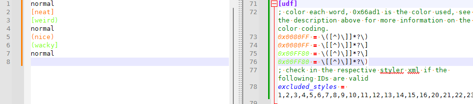

      Hello, I am currently trying to make my User Defined Language highlight some words depending on the context using delimiters but one of my delimiters ended up overlapping the other. I wanted to make different styles based on the parenthesis, like () and [] is one style and (] and [) is another style. The words in these (), [], [) and (] would also turned into that color based on the parenthesis. Therefore, I could not get the result I wanted. Is there a way to get what I am trying to achieve?
      What I am trying to achieve:
      [words] or (words) => would be in orange color
      (words] or [words) => would be in green color
      But the result i got was
      (words] or [words] ended up being orange color
      [words] and (words) were not affected

        With just the User Defined Language (UDL) syntax, what you want is probably not achievable.
        However, if you install the EnhanceAnyLexer plugin (using Plugins > Admin tool), then you can make sure your file has the right UDL active, then use Plugins > EnhanceAnyLexer > Enhance Current Language to edit the plugin’s config file. You can then define foreground color changes using “0xBBGGRR = regex” pairs.
        [udf]
        ; color each word, 0x66ad1 is the color used, see the description above for more information on the color coding.
        0x0080FF = \([^)\\]]*?\)
        0x0080FF = \\[[^)\\]]*?\\]
        0x00FF80 = \([^)\\]]*?\\]
        0x00FF80 = \\[[^)\\]]*?\)
        ; check in the respective styler xml if the following IDs are valid
        excluded_styles = 1,2,3,4,5,6,7,8,9,10,11,12,13,14,15,16,20,21,22,23
        In my example, I defined four regular expressions: two will match the balanced [...] and (...); the other two match the imbalanced [...) and (...]
        If you don’t want it to match multiline, change each of those four regex to have \r\n right after the ^, so that it doesn’t look for parenthesized text that spans across newline characters.
        note: mine used [udf] as the header, because I was in an unnamed UDL. If you follow my instructions above, yours will have [YourUdlNameHere] instead.
