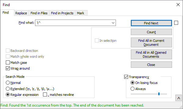

        What is your search mode? The ^ symbol is called a meta character in regular expression mode, it refers to the zero width position right at the start of a line. If in this mode you need to enter \^ to get the search engine to recognise it as a normal character.

          Search “backword” and search “Match whole word only” are greyed out
          … then @Terry-R’s guess of you being in Regular Expression mode is right, because that’s the only search mode that greys those out.

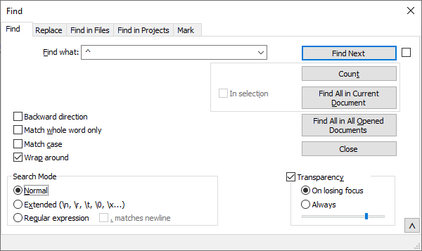

          So, you will either need to escape the ^ like \^ in your search,
          or change back to Normal search mode lile:

            Okay, you’re right that explains it. Somehow I had clicked “Regular Expression” accidentally. When I changed back to “Normal” it started working without having to put the escape character in front of it. And that’s also what caused the top 2 search choices to be grayed out.
            Thanks,
            Peter
