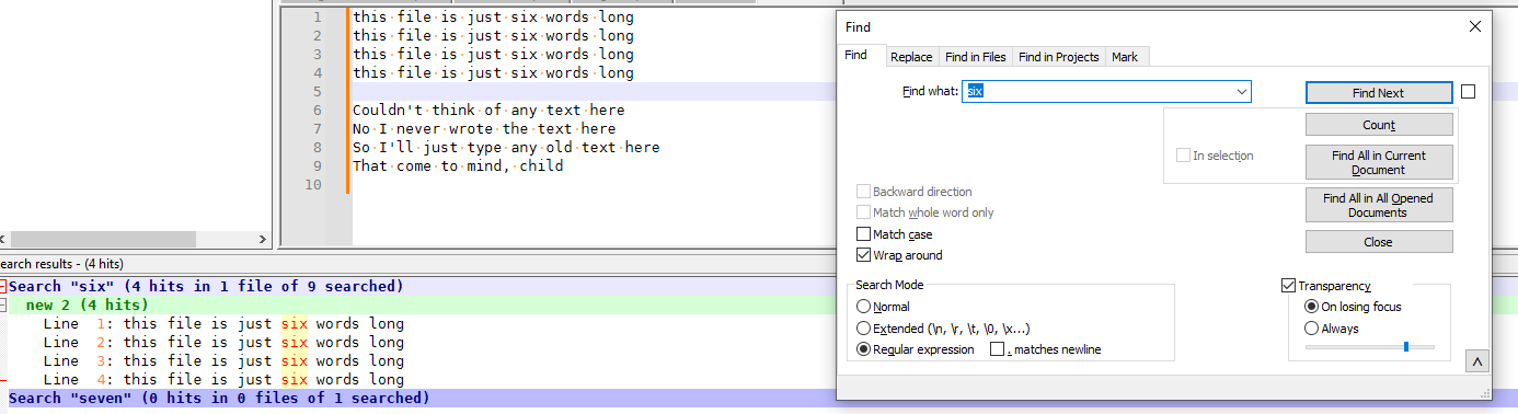

            I was going to add
            vs
            (with apologies to Weird Al. But really, if he cannot handle being parodied, who can?)
            But then Alan-Kilborn said,
            A big hint might be to uncheck Match whole word only if it is checkmarked.
            Ah, yes, that is a highly-likely culprit.
