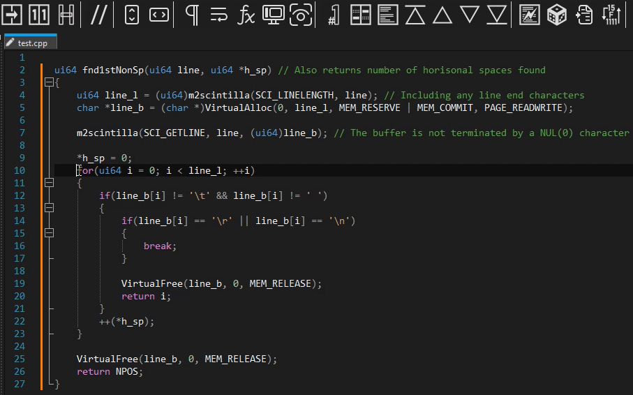

              Which is much better readable when you just want to disable some piece of your code (which is 99% of usecases for the comment/uncomment feature). Like, when you just want to write comment you just type it manually anyway!
              What sux, is that I loose one button space because now instead of just “toggle single line comment” I need 2 buttons:
              Here is buttons defined in CustomizeToolbar.btn file:
              Macro,COMMENT_LINES,,,,,butts\lcomm.ico
              Macro,UNCOMMENT_LINES,,,,,butts\undolcomm.ico
              Alan KilbornA ScienceDS 2 Replies Last reply Reply Quote 1
