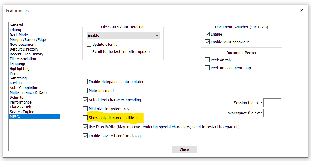

        Hello, @stimmenhotel and All,
        I suppose that the option, below, in Settings > Preferences... > MISC must be checked. In this case, just uncheck it !
        StimmenhotelS 1 Reply Last reply Reply Quote 1

          Stimmenhotel @guy038
          @guy038 Thanks for the quick tip!
          I have the path in the title bar, but is usally not the place my eyes are used to look. I will try to look more often on the titlebar, but I hoped there is maybe another way too.
            Alan Kilborn @Stimmenhotel
            @Stimmenhotel
            The titlebar approach works if the tab you are interested in is the active one. Hovering the mouse over an inactive tab will cause a little popup to appear with the full path of the tab in it.

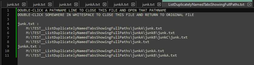

                          Perhaps a script helps here…
                          Maybe when you need to go to a specific file that you see over and over in your tabs (“So which tab do I want??”), you run a script and it shows you all of the paths to these same-named tabs, and from there you could double-click the one you need to navigate to, and it would take you there; example:
                          I call the script ListDuplicatelyNamedTabsShowingFullPaths.py :
                          # -*- coding: utf-8 -*-
                          #  ListDuplicatelyNamedTabsShowingFullPaths (LDNTSFP)
                          # references:
                          #  https://community.notepad-plus-plus.org/topic/24685
                          from Npp import *
                          import inspect
                          import os
                          class LDNTSFP(object):
                              def __init__(self):
                                  self.this_script_name = inspect.getframeinfo(inspect.currentframe()).filename.split(os.sep)[-1].rsplit('.', 1)[0]
                                  self.this_script_path_without_ext = inspect.getframeinfo(inspect.currentframe()).filename.rsplit('.', 1)[0]
                                  self.results_file = self.this_script_path_without_ext + '.txt'
                                  self.original_file = None
                                  editor.callback(self.doubleclick_callback, [SCINTILLANOTIFICATION.DOUBLECLICK])
                              def run(self):
                                  pathlist_by_tabtext_dict = {}
                                  view_0_tabtext_list = []  # for detecting cloned-files
                                  for (pathname, buffer_id, index, view) in notepad.getFiles():
                                      if not os.path.isfile(pathname): continue  # skip any soft-named tabs
                                      tab_text = pathname.rsplit(os.sep, 1)[-1]
                                      if view == 0:
                                          view_0_tabtext_list.append(tab_text)
                                      elif tab_text in view_0_tabtext_list:
                                          continue  # don't consider a cloned file as a duplicate tab for purposes of this script
                                      if tab_text not in pathlist_by_tabtext_dict:
                                          pathlist_by_tabtext_dict[tab_text] = [ pathname ]
                                      else:
                                          pathlist_by_tabtext_dict[tab_text].append(pathname)
                                  results_file_line_list = [
                                      'DOUBLE-CLICK A PATHNAME LINE TO CLOSE THIS FILE AND OPEN THAT PATHNAME',
                                      'DOUBLE-CLICK SOMEWHERE IN WHITESPACE TO CLOSE THIS FILE AND RETURN TO ORIGINAL FILE',
                                  have_at_least_one_duplicate_tab_name = False
                                  for tab_text in pathlist_by_tabtext_dict:
                                      if len(pathlist_by_tabtext_dict[tab_text]) > 1:
                                          have_at_least_one_duplicate_tab_name = True
                                          results_file_line_list.append(tab_text + ' :')
                                          for path in pathlist_by_tabtext_dict[tab_text]:
                                              results_file_line_list.append('\t' + path)
                                  if have_at_least_one_duplicate_tab_name:
                                      self.original_file = notepad.getCurrentFilename()
                                      notepad.activateFile(self.results_file)  # in case it is already open
                                      if notepad.getCurrentFilename() != self.results_file:
                                          open(self.results_file, 'w').close()  # so notepad.open() won't prompt or fail on non-existent file
                                          notepad.open(self.results_file)
                                          assert notepad.getCurrentFilename() == self.results_file
                                      eol = ['\r\n', '\r', '\n'][editor.getEOLMode()]
                                      editor.setText(eol.join(results_file_line_list))
                                      notepad.save()
                                      editor.setReadOnly(True)
                                  else:
                                      self.mb('Currently there are no duplicately named tabs.')
                              def doubleclick_callback(self, args):
                                  if notepad.getCurrentFilename() == self.results_file:
                                      double_click_pos = args['position']
                                      if double_click_pos == -1:
                                          # not close to any text; simply return to original document
                                          notepad.close()  # close the file double-clicked in
                                          if self.original_file is not None:
                                              notepad.activateFile(self.original_file)
                                      else:
                                          double_click_line = editor.lineFromPosition(double_click_pos)
                                          dclick_line_content = editor.getLine(double_click_line)
                                          pathname_to_open = dclick_line_content.strip()
                                          if os.path.isfile(pathname_to_open):
                                              notepad.activateFile(pathname_to_open)
                              def mb(self, msg, flags=0, title=''):  # a message-box function
                                  return notepad.messageBox(msg, title if title else self.this_script_name, flags)
                          if __name__ == '__main__':
                              try:
                                  ldntsfp
                              except NameError:
                                  ldntsfp = LDNTSFP()
                              ldntsfp.run()
                          The script opens a new file and then waits for you to do something (i.e., double-click) in that file. When that happens, this special file closes and you are back on your way with what you need to work on next.
                          Moderator EDIT (2024-Jan-14): The author of the script has found a fairly serious bug with the code published here for those that use Mac-style or Linux-style line-endings in their files. The logic for Mac and Linux was reversed, and thus if the script was used on one type of file, the line-endings for the opposite type of file could end up in the file after the script is run. This is insidious, because unless one works with visible line-endings turned on, this is likely not noticed. Some detail on the problem is HERE. The script above has been corrected per that instruction.

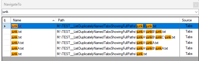

                          • Mark OlsonM Offline
                            Mark Olson @Stimmenhotel
                            @Stimmenhotel said in Showing File-Path in Tab or above editor window:
                            I’m glad that you think my PR would have been useful!
                            Maybe this can be added as a plugin?
                            In any case, the NavigateTo plugin is good for working with large numbers of files in general, and it’s also pretty good for dealing with files that have duplicate filenames.
                            As shown in the above example, NavigateTo is really useful for sifting through files that may have the same name or similar names. If you do decide to use NavigateTo, I highly recommend downloading a recent release.
                            StimmenhotelS 1 Reply Last reply Reply Quote 3

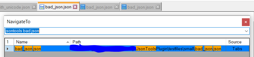

                              Here’s NavigateTo showing my fileset…not bad:
                              • StimmenhotelS Offline
                                Stimmenhotel @Mark Olson
                                @Mark-Olson Quite clunky, but perfect for now. Thanks for the recommendation.
