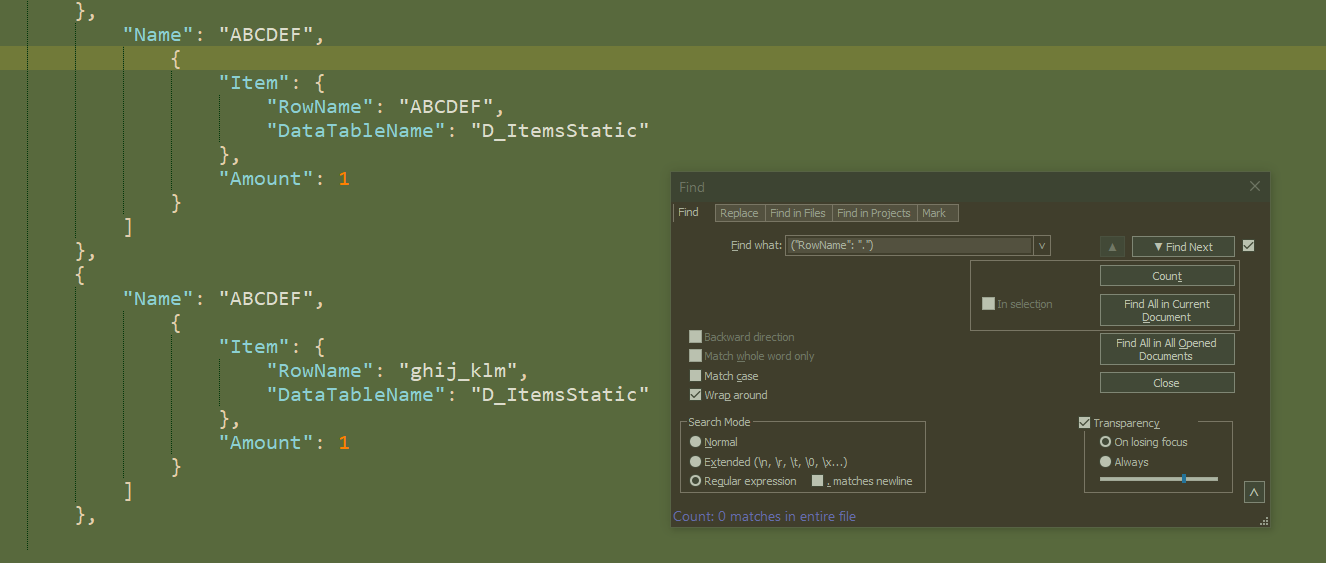

          • CK DexterhavenC Offline
            CK Dexterhaven @PeterJones
            @PeterJones Well, apologies, I saw the thing about the formatting but didn’t think it would be such a big deal. I’ll make sure to be more precise next time.
            I for sure had the regex radio button clicked, and have double-checked that here and still not seeing it, using either the carat-and-dollar sign chars or not…
            PeterJonesP Paul WormerP 2 Replies Last reply Reply Quote 0
              PeterJones @CK Dexterhaven
              @CK-Dexterhaven said in Regex use:
              It’s not just being picky. Regex are highly dependent on the actual data. The sole reason that my first regex didn’t work for you is because you were not precise enough because you had not followed the advice in that FAQ.
              If I had made a regex to work on the data that we could see in the forum post, it would have been matching “smart quotes”, not ASCII " quotes, which would not have worked for your data, based on your followon screenshot. The more times you give us misinformation about your data, the more time we waste helping you solve the wrong problem. This is why the formatting, and the other advice in that template, are of critical importance.
              In addition to that bad data:
              Your screenshot also shows that your data is not at the beginning of the line. Your example data implied that the data was at the beginning of the line. (@Coises already pointed this out to you.) Since it’s not at the beginning of the line, using ^ in the regex will not work, because that anchors it to the beginning of the line. If you had used the formatting box and pasted real data into that box, we could have seen that there were leading spaces in your data, and would have told you earlier that the ^ anchor doesn’t work for your data.
              Further, the line for your "RowName": "value", pair has a comma after the end quote, so using the $ to anchor it so the end quote must be right next to the end-of-line will not work (because the comma, not the quote mark, is next to the end of line; and maybe there’s even spaces after the comma that we cannot see).
              Hence, both the ^ and $ are wrong for your data, but we couldn’t tell that because you didn’t give good example data. The reason I spent the time writing up that FAQ with the template on how to do Search/Replace questions is because when new users of the forum ask their questions like you did, ignoring the advice of the FAQ, it takes multiple times back and forth before we can drag it out of you that the data you showed didn’t actually match the data that you wanted the regex to match, wasting everyone’s time.
              Further, you originally said “where X or Y is any character string”, which I interpreted to mean “is any single character string”, though @Coises was astute enough to point out that it was probably a bad assumption, too.
              new solution
              Now that we know better what your data looks like, the correct regular expression is probably:
              FIND WHAT = ("RowName": "\C+")
              Note that there is no more ^ at the beginning or $ at the end, and that it’s using \C+ to indicate one or more characters, rather than a single character, between the quotes.
              I say “probably” because you gave a screenshot rather than pasting real text into the </> code/plaintext block, so I still cannot copy/paste a real example of your data into my copy of Notepad++; because of that, I can only guess that I’ve properly interpreted the text from your screenshot

                  • Mark OlsonM Offline
                    Mark Olson
                    Just wanted to observe that the OP posted a picture using what appears to be the MossyLawn theme. Now that’s good taste.
