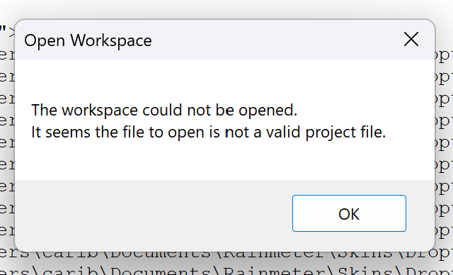

      I’m trying to use the below PS1 script to replace the username in each line of the Workspace file to a different username. The script works, and the text is replaced correctly, but afterwards the Workspace file no longer works in Notepad++. Is there a specific filetype or encoding I need to set in order for the formatted file to be readable/usable in Notepad++ after the script is run?

          I receive this error when trying to load it in the Project Pane in Notepad++
