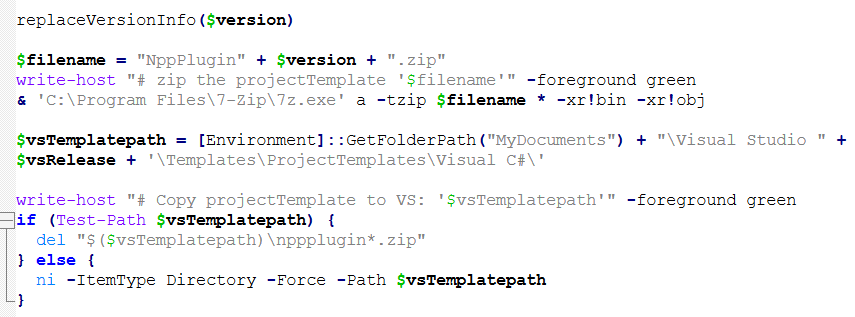

        If your goal is to only color the $ itself green and not the rest of the variable, I’d recommend using the EnhanceAnyLexer plugin.
        Just use
        [powershell]
        ; $ in variable names is green
        0x00c300 = \$(?=\w)
        ; just comment out, seems to work best for non-UDLs
        ; excluded_styles = 0,1,2,3,4,5,6,8,9,10,13,14,15,16
        in %AppData%\Roaming\Notepad++\plugins\Config\EnhanceAnyLexer\EnhanceAnyLexerConfig.ini
        Result:
        Unfortunately, this doesn’t colorize $ inside of quoted regions. This is outside the scope of EnhanceAnyLexer, it would seem.
          Hello, @cooly0, @mark-olson and All,
          @mark-olson, from your picture, the first $ sign, in the part between quotes :
          del "$($vsTemplatepath)\nppplugin*.zip"
          Is not colored in green. This is quite normal as your regex is \$(?=\w). I suppose that the correct regex should be, in this case, \$(?=[\w(])
          So, it’s not a limitation of the @Ekopalypse’s plugin !!
