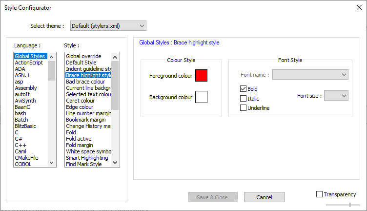

        That’s because there isn’t an entry in the Settings > Preference dialog for turning on or off the matching. What has presumably changed is that your Settings > Style Configurator > Global Styles > Brace highlight style is not meaningfully set for your active Theme… which implies that something corrupted your Theme when you upgraded. I don’t know how it got corrupted, but you can fix it by setting a reasonable color there. The default is red foreground and white background.

          Thanks for the reply. I tried your suggestion, but still not seeing the pairing. Previously, if I placed the cursor next to a delimiter, e.g. “{” “[” or “(”, the paired one would be highlighted, i.e. “}” “]” or “)”. I don’t recall which color they would come up as (green maybe). If one were unpaired, the unmatched one would be highlighted red. Extremely helpful in debugging. After applying your suggestion, I still get no highlighting when placing the cursor next to a delimiter.

            1. You didn’t understand my instructions, so think you’ve followed them but haven’t
              • to confirm, please show a screenshot of Settings > Style Configurator > Global Styles > Brace highlight style: 370d33db-500c-4044-9adf-584ce34f4c4a-image.png

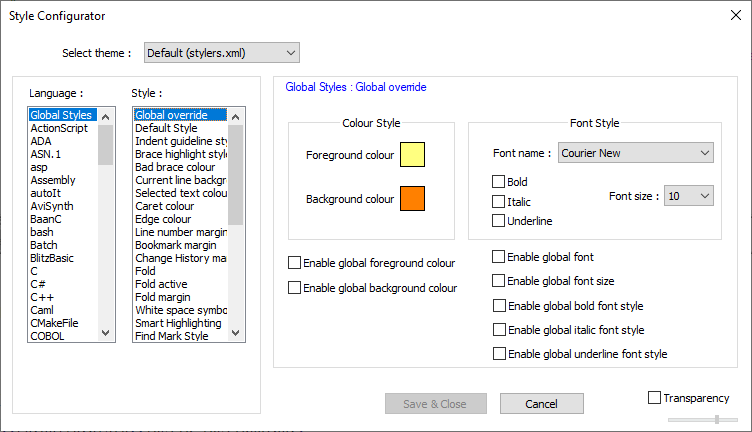

            2. You have global override colors turned on, so you get no syntax highlighting, including no braces
              • to confirm, please show a screenshot of Settings > Style Configurator > Global Styles > Global override: d9f4e6d9-b328-42dc-95eb-b99caeda74ea-image.png

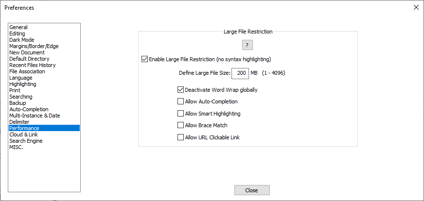

            3. You have a file greater than 200Mb, and thus Settings > Preferences > Performance is kicking in.
              • to confirm, please show a screenshot of Settings > Preferences > Performance: e9781d18-b1f8-456e-b33a-bef1d1041fe9-image.png
              • and also your entire status bar at the bottom of Notepad++: c7f53601-4188-4af4-a972-18ea2d25afa6-image.png
              • the first will show where your threshold is; the second will show how big your file is

              It was #2, I had global override on. I’ve shut it off, now back to normal.
              I guess I was trying so many things, I didn’t realize I had this on.
