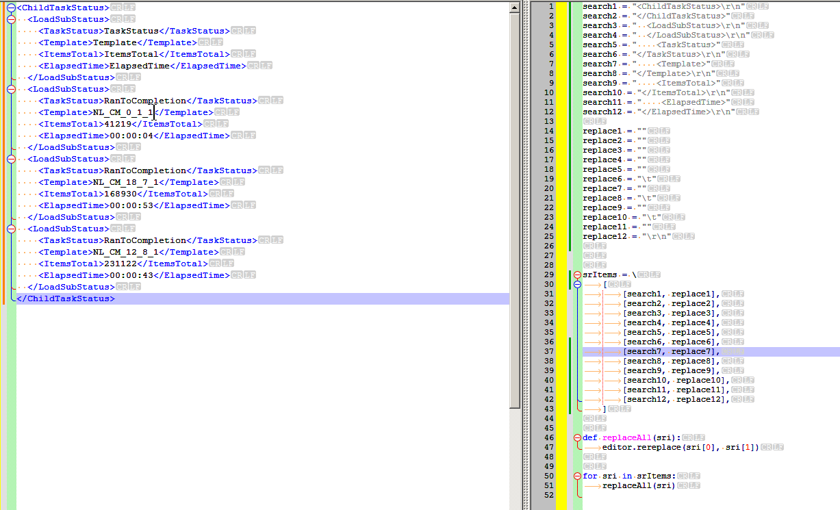

        @Bas-de-Reuver I use an online tool for converting XML to CSV but I assume this is not an option.
        Bas de ReuverB 1 Reply Last reply Reply Quote 0

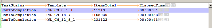

        • Bas de ReuverB
          Bas de Reuver @datatraveller1
          @datatraveller1 it’s not an option in this case due to the XML containing privacy data, but I’m curious which online tool you’re referring to?
          Anyway I also asked the question on superuser.com and someone suggested simply opening the file in Excel which handles random XML files pretty well. It just didn’t occur to me to open an XML file in Excel because quite often it can’t even handle a simple csv file. 😆

              The example you show has the same four column-elements in the same order in every row-element. Is that true of the real data?
              Bas de ReuverB 1 Reply Last reply Reply Quote 1
              • wonkawillyW
                wonkawilly
                If the schema is constant I can suggest to use find and replace multiple times and create a macro saving the whole procedure in the meanwhile so you have it for future uses

                              The following should work as well: (you need PythonScript Plugin in order to be able to run the script)
                              The data:
                              <ChildTaskStatus>
                                <LoadSubStatus>
                                  <TaskStatus>TaskStatus</TaskStatus>
                                  <Template>Template</Template>
                                  <ItemsTotal>ItemsTotal</ItemsTotal>
                                  <ElapsedTime>ElapsedTime</ElapsedTime>
                                </LoadSubStatus>
                                <LoadSubStatus>
                                  <TaskStatus>RanToCompletion</TaskStatus>
                                  <Template>NL_CM_0_1_1</Template>
                                  <ItemsTotal>41219</ItemsTotal>
                                  <ElapsedTime>00:00:04</ElapsedTime>
                                </LoadSubStatus>
                                <LoadSubStatus>
                                  <Template>NL_CM_18_7_1</Template>
                                  <ItemsTotal>168930</ItemsTotal>
                                  <ElapsedTime>00:00:53</ElapsedTime>
                                </LoadSubStatus>
                                <LoadSubStatus>
                                  <Template>NL_CM_12_8_1</Template>
                                  <ItemsTotal>231122</ItemsTotal>
                                  <ElapsedTime>00:00:43</ElapsedTime>
                                </LoadSubStatus>
                              </ChildTaskStatus>
                              The Python script:
                              search1 = "<ChildTaskStatus>\r\n"
                              search2 = "</ChildTaskStatus>"
                              search3 = "  <LoadSubStatus>\r\n"
                              search4 = "  </LoadSubStatus>\r\n"
                              search5 = "    <TaskStatus>"
                              search6 = "</TaskStatus>\r\n"
                              search7 = "    <Template>"
                              search8 = "</Template>\r\n"
                              search9 = "    <ItemsTotal>"
                              search10 = "</ItemsTotal>\r\n"
                              search11 = "    <ElapsedTime>"
                              search12 = "</ElapsedTime>\r\n"
                              replace1 = ""
                              replace2 = ""
                              replace3 = ""
                              replace4 = ""
                              replace5 = ""
                              replace6 = "\t"
                              replace7 = ""
                              replace8 = "\t"
                              replace9 = ""
                              replace10 = "\t"
                              replace11 = ""
                              replace12 = "\r\n"
                              srItems = \
                              		[search1, replace1],
                              		[search2, replace2],
                              		[search3, replace3],
                              		[search4, replace4],
                              		[search5, replace5],
                              		[search6, replace6],
                              		[search7, replace7],
                              		[search8, replace8],
                              		[search9, replace9],
                              		[search10, replace10],
                              		[search11, replace11],
                              		[search12, replace12],
                              def replaceAll(sri):
                              	editor.rereplace(sri[0], sri[1])
                              for sri in srItems:
                              	replaceAll(sri)
                              Situation before running the script:
                              Result after running the script:
                              The script of course can be further simplified and also you can replace the \t with comma or semicolon or any other symbol you like/need to achieve your purpose.
