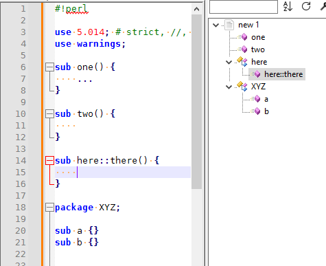

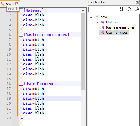

          For things like an INI file, or code in a language that Notepad++ knows about (like C++ or JavaScript or Perl or Python or most of the other 90ish Language-menu entries), you get that for free with the built-in feature Function List (which @Lycan-Thrope pointed you to), without any plugins or extra config files needed.
          c5122f53-cb0d-469b-84e1-bfe89d8f8cf2-image.png or ae864b7b-be57-45a1-8bf9-16338af8f2bf-image.png
          But, as @Lycan-Thrope said, if you are dealing with unique code that Notepad++ doesn’t know about, then you have to define a UDL for that code, and then define a Function List definition file for that UDL, which will take effort.
