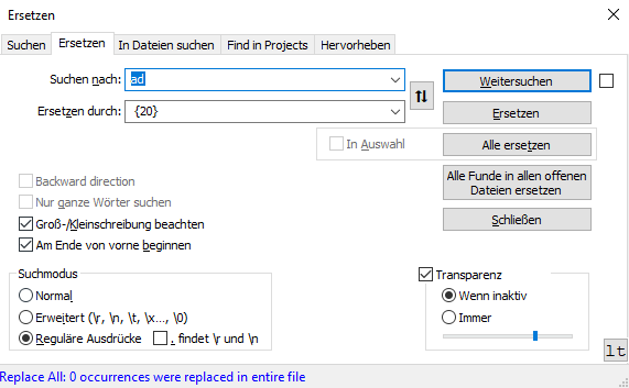

      Hi,
      can someone tell me, where my brain has decided to go on holiday regarding the replacment regex in notepad serach/replace
      i have a string ex. “ad” and i want to replce that string with a number of spaces say 20.
      my idea:
      c30ba6b8-4499-48b4-95f9-8b8601346434-image.png .
      my result:
      I have found nothing so far that says this should not work.
      I’d be glad for any news even if it’s just, that np++ does not work like that ;)
      P.S.: Notepad Version V 8.4.8 64bit
      Alan KilbornA Mark OlsonM wonkawillyW 3 Replies Last reply Reply Quote 0

          @black_cat
          Consult the regex documentation.
          The basic issue is that while there is special syntax for replacements, it is different from the searching syntax. This is true of all regex engines For example, \x20{20} (I used \x20 for the space character) matches 20 spaces when searching, but the only way to insert 20 spaces in a replacement is \x20\x20\x20\x20\x20\x20\x20\x20\x20\x20\x20\x20\x20\x20\x20\x20\x20\x20\x20\x20

                  I’m afraid that the Npp Search and Replace dialog can’t use the regex you typed into the Replace textbox but only into the Search textbox.
                  This is because in case of using regex, the replace part of the Find and Replace function is interpreted in a different manner than the find part: the {20} part is in fact interpreted literally, as a normal text string.
                  But a possible solution is to use Python script (you must have already installed the relative plugin) than you have to open its console and type the following command into its command line;
                  editor.rereplace('ad', ' ' * 20)
                  that instruct Python to fined “ad” and replace it with 20 spaces. Than hit run. You should obtain your wished result.
                  Another valid alternative of course is to actually type 20 spaces into the Replace textbox.
