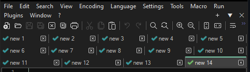

        pmeriwether @Alan Kilborn
        I am trying to remove the white outline from the tabs in the first image to make them appear the same as the tabs in the second image.
        I preferred the incomplete outline and more compressed feel. It isn’t the color, but the outline and separation.

            • PeterJonesP Online
              PeterJones @pmeriwether
              @pmeriwether said in Tab Changed appearance on update:
              As far as I know, in my years of documenting the Preferences menu, I have never seen a setting that will draw a full box with a full outline.
              My guess is that you’ve got a plugin that does it. As Alan says, you should be “specific about what version number”, and the most reliable way to do that is to go to ?-menu’s Debug Info, and copy the contents of that window (with Ctrl+C or clicking the "copy debug info to clipboard) – as this gives us version, bitness, various settings, and the list of plugins you have installed.
              The reason I highly recommend Debug Info in this situation is because I am quite confident that it’s one of your plugins that’s causing the display difference. I would recommend following the advice in our FAQ section on “Possible Culprit: Plugin” to narrow down which one. (yes, I know your problem isn’t a crash of Notepad++, but the debugging procedure in the FAQ for narrowing down which plugin is causing a problem is exactly the procedure you need to follow here). If you find a culprit, then either change the settings for that plugin, or remove it, to get rid of that behavior.
              If you can prove it’s still displayed wrong with no plugins active, then please also share your Theme choice, and a screenshot of your Preferences > Dark Mode . I don’t see how any of those could cause the problem you’ve shown, but if it’s not a plugin, I will be grasping at straws.
                      @pmeriwether ,
                      Thanks. I can confirm with a portable v8.5.3: it’s the multi-line Tab Bar option in combination with being in Dark Mode. In Dark Mode with single-line tab bar,
                      In Dark Mode with multi-line tab bar:
                      I went back and bisected versions: v8.4.8 matches your “old” screenshot
                      but v8.4.9 looks the same as the v8.5.3 screenshots from above.
                      I cannot see anything in the release notes that indicate a change that affects the tab bar, but that doesn’t mean that it wasn’t something he didn’t bother to include in the notes.
                      pmeriwetherP 1 Reply Last reply Reply Quote 3
                      • pmeriwetherP Offline
                        pmeriwether @PeterJones
                        @mkupper
                        I found I am able to change the color through using customized tones, please see the screenshot.
                        I can take it from here, thank you both!
