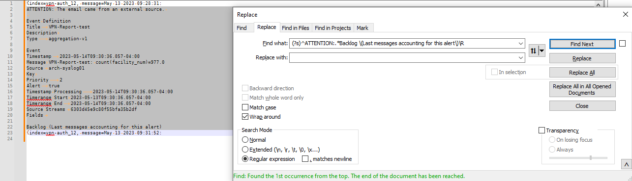

        PeterJones @Robert Oram
        @Robert-Oram ,
        Use ^ to anchor to the beginning of the line, and use . matches newline or the regex (?s) equivalent to make .*? go across multiple lines. Also, because parentheses are meaningful to regex, you will need to escape them as \( and \)
        For example, FIND = (?s)^ATTENTION:.*Backlog \(Last messages accounting for this alert\)\R and REPLACE WITH nothing, in regular expression mode, gave the Final Result you asked for.
        Here’s a screenshot with the match and dialog shown:
