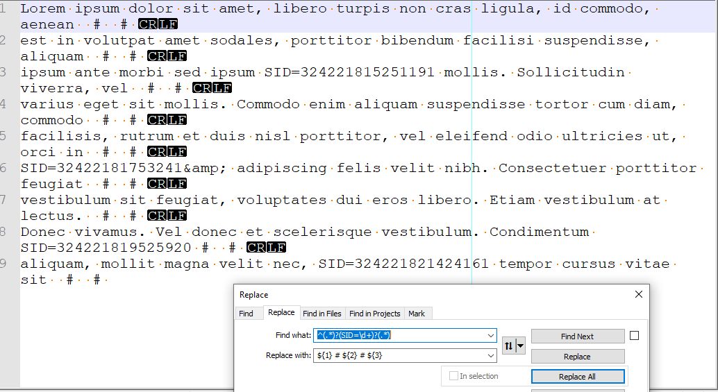

      I have a file containing many lines, and some of the lines contain a single pattern within them like SID=29394030394.
      My desire is to remove everything from the file except for those strings.
      I have the following in the Find/Replace dialog:
      Find what: ^.*?(SID=\d+)?.*
      Replace with: \1
      But it simply removes everything from the file (edit: unless SID=\d+ is the first thing on the line).
      If I remove the second question mark, i.e., ^.*?(SID=\d+).*, then it will successfully replace each found instance with just the string, but it leaves the rest of the lines intact.
      What am I missing?
      Sample data:
      Lorem ipsum dolor sit amet, libero turpis non cras ligula, id commodo, aenean
      est in volutpat amet sodales, porttitor bibendum facilisi suspendisse, aliquam
      ipsum ante morbi sed ipsum SID=324221815251191 mollis. Sollicitudin viverra, vel
      varius eget sit mollis. Commodo enim aliquam suspendisse tortor cum diam, commodo
      facilisis, rutrum et duis nisl porttitor, vel eleifend odio ultricies ut, orci in
      SID=32422181753241& adipiscing felis velit nibh. Consectetuer porttitor feugiat
      vestibulum sit feugiat, voluptates dui eros libero. Etiam vestibulum at lectus.
      Donec vivamus. Vel donec et scelerisque vestibulum. Condimentum SID=324221819525920
      aliquam, mollit magna velit nec, SID=324221821424161 tempor cursus vitae sit

                                • (SID=\d+).* if the SID=... string begins the current line. In this case the group 1 is defined and the regex engine changes all contents of current line with the string SID=.....
                                Finally, note that your second regex ^.*?(SID=\d+).* matches ONLY the lines containing a SID=... string. Thus, it’s obvious that the other lines remain untouched !
                                Neverthless, it was easy to solve your problem. You ( and I ) could have thought of this regex S/R !
                                SEARCH (?-s)^.*(SID=\d+).*|.+\R
                                REPLACE \1
                                • When a line contains the SID=.... string, it just rewrites that string ( group 1 )
                                • When a line does not contain a SID=.... string, the second alternative of the regex, .+\R grabs all contents of current line WITH its line-break. But, as this second alternative does not refer at all about the group 1, nothing is rewritten during the replacement, and the lines are just deleted
