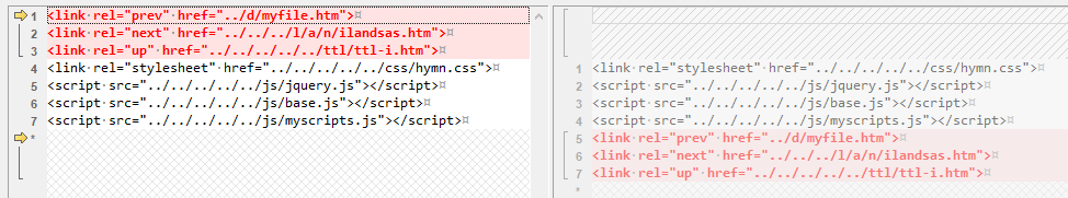

        Alan Kilborn @Dick Adams 0
        A visual on the difference maybe helps:
